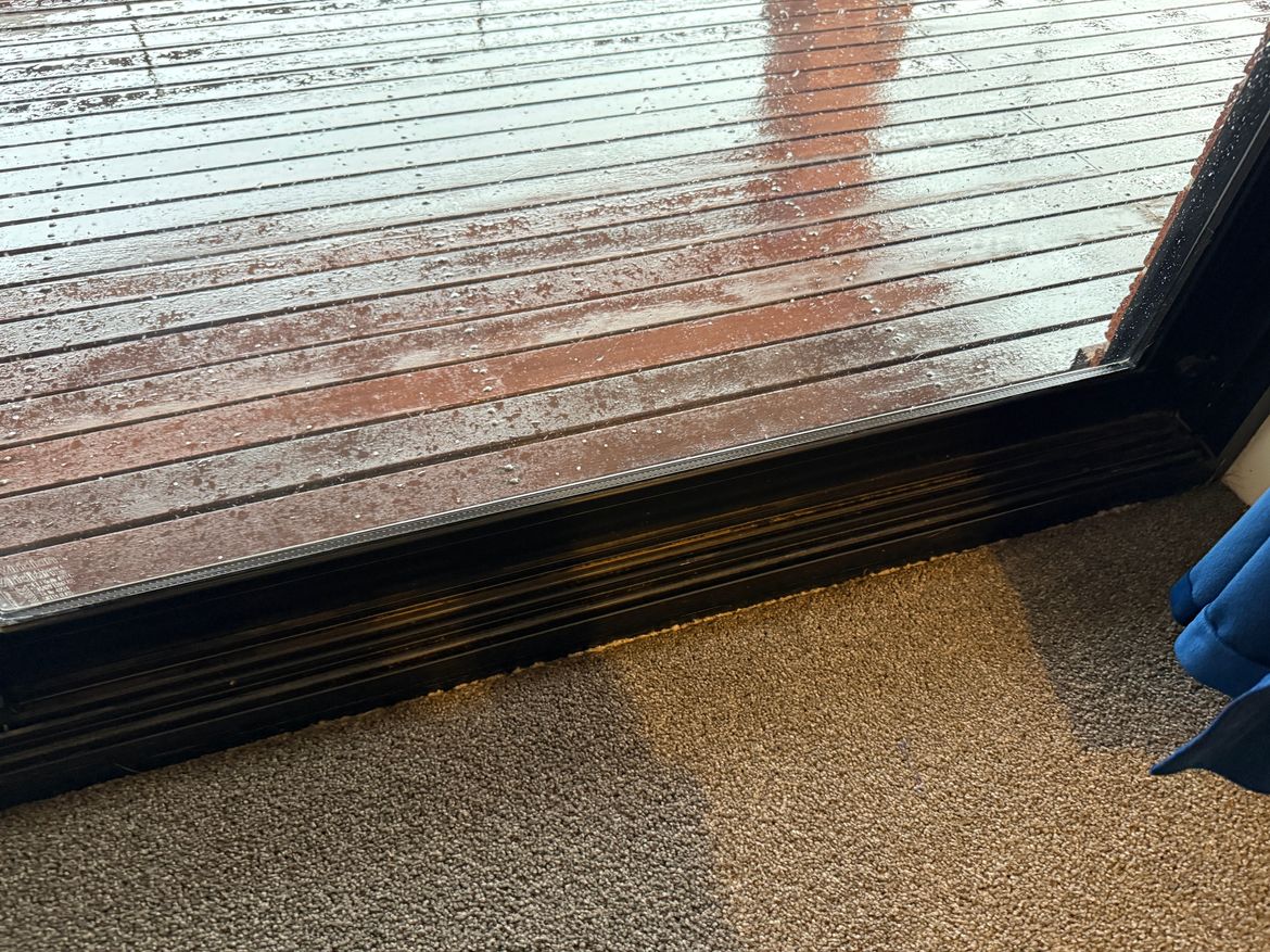

I have bedroom with huge sliding door that is double glazed. however the bedroom is always cold. I noticed that the sliding door tracks where the door slides pumps cools air from outside making the room extremely cold, is there a way insulate these gaps?IMG_2589.JPGIMG_2591.JPGIMG_2590.JPG

Hello @jp171
If there is enough space between the sliding door and one of the rails, I suggest looking at installing a Moroday 6 x 7mm x 5m Black MWS8 Self-Adhesive Brush Seal. But if there is no space for it, I recommend putting two 88cm x 5.3cm x 5.3cm Assorted Colour Door Snake to stop any cold air from flowing under the door. The snakes can be removed when using the door and repositioned when its closed.
