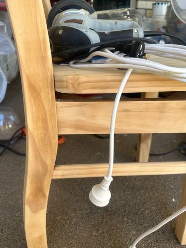

I’m upcycling my dining table and chairs. I’ve sanded them back to natural wood and it looks to be made of pine (see first two images of the up close wood). I want to transform these into a coastal vibe, light ashy colour same as the colour of the dining table in image 3.

I'd agree that your table and chairs appear to be made of pine, which gives us a good point to start from.
