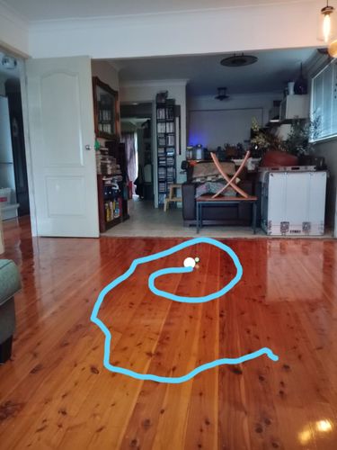

Afternoon @Riri
I must admit it surpprised me twhen i found the same tiles overlaid with more tiles :smile: I have that in my loungeroom when stepping into the dining room. It has been that way for the past 15 years :surprised: lol I still havnt given it an edge.
I am thinking of
PermaTimber® 21 x 21mm 2.7m Tasmanian Oak Composite Equal Angle Corner Trim Will need a trim down on one side is all
 or
Metal Mate 12 x 12 x 1.4mm 3m Aluminium Equal Angle - Silver  The 2mm difference you wont notice.
As an edge for the transition.Both ways I would use liquid nails to glue it down. My prefernce without seeing a photo is the second as it has a smaller look impact.
I have never tripped on my exposed edge, As long as its clearly seen I wouldnt think of it as a problem.
