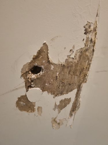

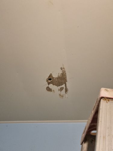

How would I go about fixing this hole in my ceiling plasterboard, it looks like someone has tried to fix it with plaster in the past. I'm not 100% sure where to start.

You should purchase a Gyprock CSR 1.5kg DIY Rapid Plaster Repair Kit as it contains everything you will need to carry out this repair.
Start by ensuring you are wearing your personal protective equipment, specifically a mask and eye protection. Use the broad knife to remove any flaky paint from the surrounds, then use the sanding block to take off the sharp edge on the paint. Once the area is prepared, put a strip of the easy tape over the hole then mix up some of the rapid patch.
Remember, plastering is all about applying material, and gently removing it. Initially it is best to put more material than needed as you can always remove it. Apply enough to completely cover the tape so it cannot be seen through the plaster. Then, using the broadknife you want to gently feather away the material until you have a smooth, flat surface without any bubbles or obvious edges.
Once this is done, let the plaster dry for at least an hour, before sanding to a smooth finish, cleaning off the dust and finally painting.
