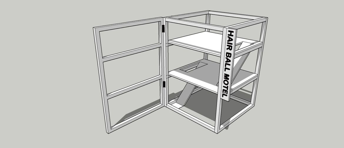

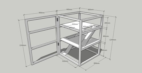

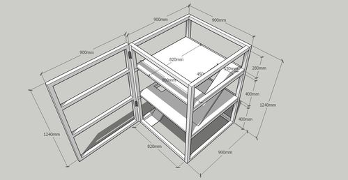

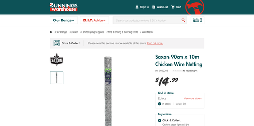

Here is a plan for the cat motel.
Tools : Hammer,saw, drill, pencil, ruler
Materials :

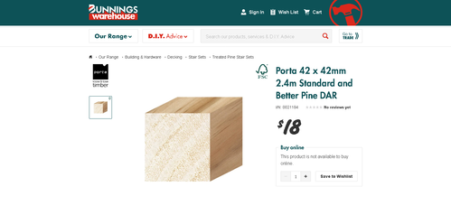

42 x 42 x 2.4 DAR plain pine ( do not get treated as it is not good for you or the cat  )

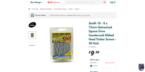

75mm timber screws ( 100 in a box )
chicken wire mesh ( or at least an equivalent where the cat can't pass his head through )
U nails to hols the chicken wire ( 50 in a box? )
2 hinges and possibly an eye and hook fence lock.
I only suggest once assembled to keep the hotel in the sun for at least a week so that the sun can bake the smell off the timber or you may paint it. Just be aware that you must let the paint dry very well as cats as we know have a very keen sense of smell. You may re-size the hotel to fit your needs ( I suggest bringing the size down to 800mm in width and length so that it fits through doorways. )  Enjoy the plans, be safe. I found this very easy video to follow on how to make a timber frame box. https://www.youtube.com/watch?v=uSvpYh5OBYU
