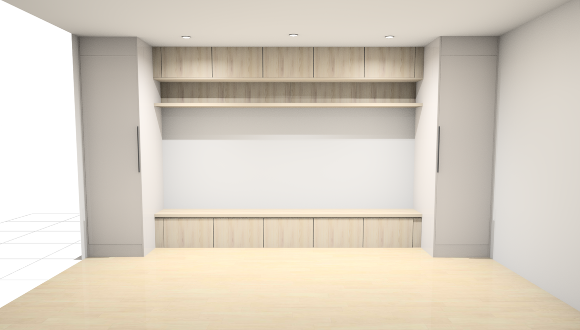

I'm looking at ideas how I might be able to achieve this image below with flat packs.
I contacted a cabinet maker, and the quote range was 10k - 15k which is way out of my range.
I've got a width of 4500 and a height of 2400 to work with.
I'm thinking potentially Kitchen cabinets for the tall ones ... but not sure what do do for the middle bit (which will be around 2700 wide if I use 600wide cabinets on the left and right)
For the bench top and the long shelf, what could I use that's 2700 long ... I'm thinking something with a veneer, but I know from experience I'm not great at laminating myself!
Also, how would I make that shelf floating, but also strong enough to hold books?

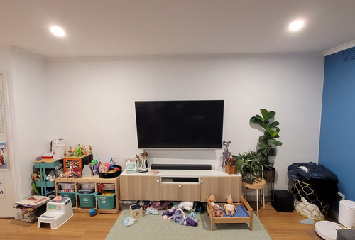

This is the space I'm working with:
Thanks
Itai

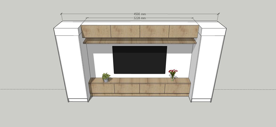

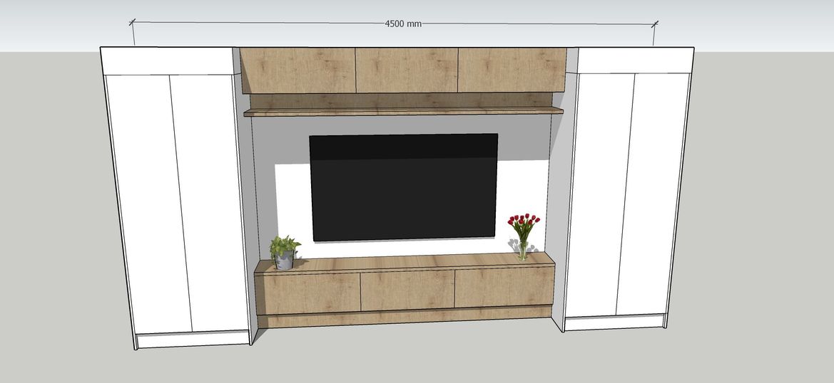

Hi @Itai
My apologies for the delay, I just wanted to make sure that the cabinets I was going to recommend were available. I've drawn up a very close replica of the assembly you posted. However, I suggest visiting your local store and looking at the cabinet finishes to see which one catches your eye. The tall pantry cabinets are standard 900mm and the cabinets in the middle are slimline 900mm. The only cabinets that are custom ordered at the store will be the one's dead centre as they will come as less than 900mm. Please have a look and tell me what you think.
The shelf at the top by the way is held in place with angle brackets. They can be installed out of sight and can support books if that's what you're planning to put in them.
If you have any other questions, please let us know.
Hey Eric.
That looks good.
Wondering though, what would it look like if I put 2 x 600 pantry cabinets on either side, leaving around 2.1m for the middle bit?
Also, do I need to leave a gap either end of the cabinets for the doors to be able to open? Which could take an additional 5cm on either side or so?
Regards
Itai

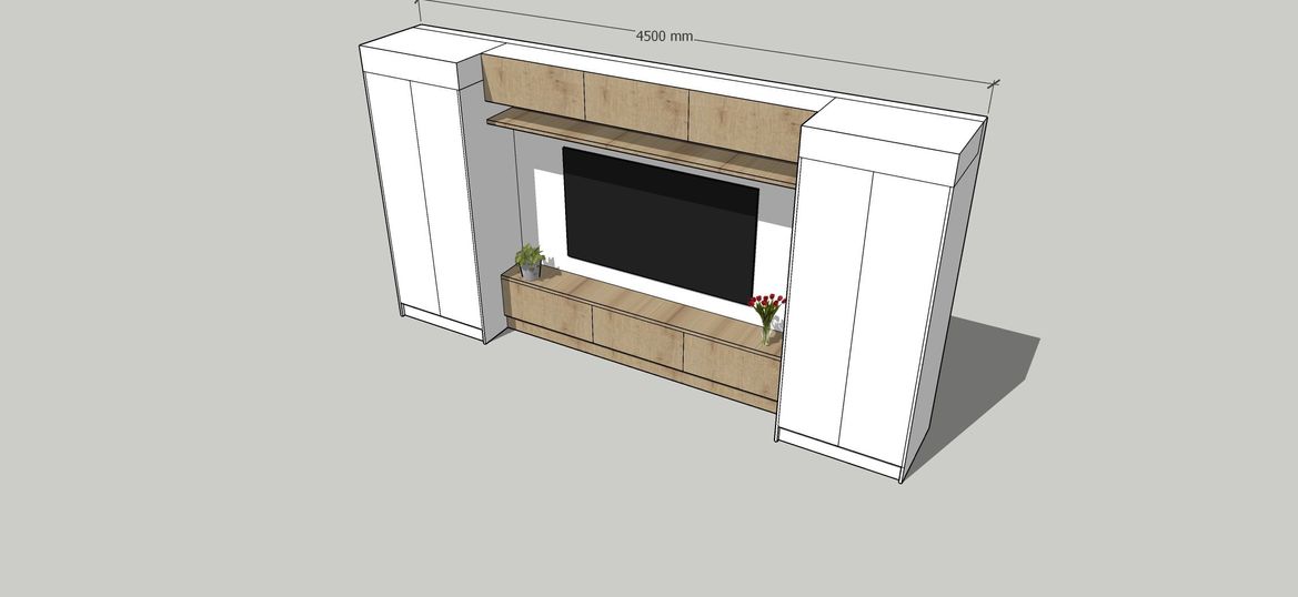

Hi @Itai
I've placed 18mm end panels on your tall cabinets and they should be enough to allow you to open the door to at least 90% of its actual swing. However, if you were to use low-profile handles you'll be able to open them to full. I've modified the drawing for you, please have a look.
