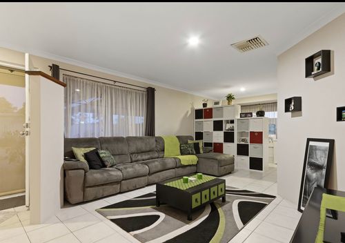

Will definitely try it, room size is 8x3m
See the picture below , it’s a bit photoshopped by real estate agents!

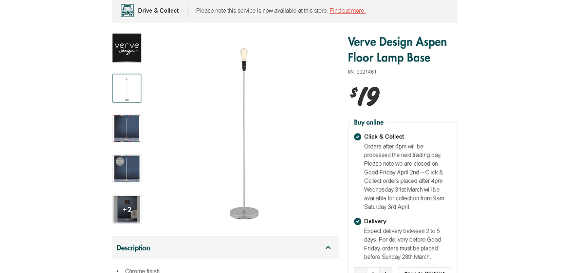

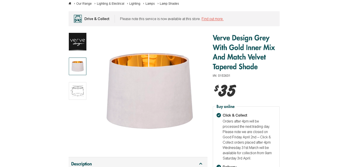

Below are the pictures for a self decor DIY lamp. The lamp assembly is easy enough you just need to pick a lamp shade that you like as it is sold separately. A strong LED lamp will usually put out a lumen or light level of 900 to 1600 lumens. It is about the equivalent of an old 100 watt lamp. But a lot of that light is directed light and will not cast a a wide cone of brightness. A floor lamp with a thin lamp shade cover can cast more light while using a reasonably bright LED bulb. There are so many choices for the type and shape of floor lamp but my suggestion is to get one that goes with your current decor, I strongly suggest that you to consider this idea as it is both economical and can be easily to install. I've placed my suggestions below but please visit your local Bunnings store and check out whats available!
