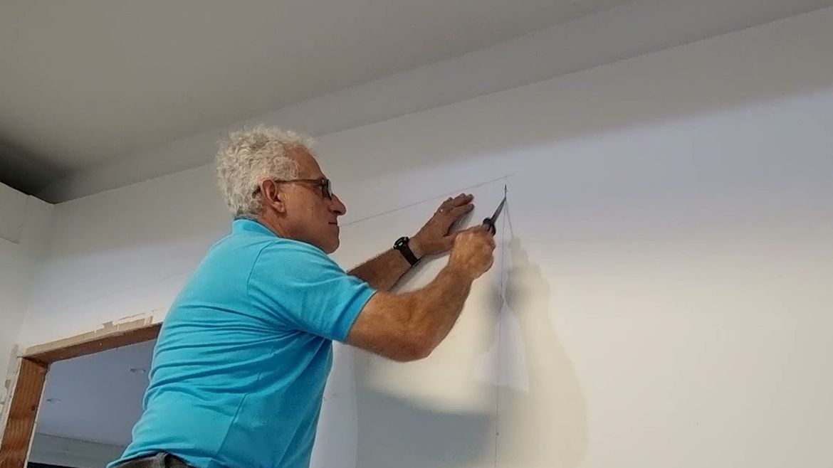

Step 2
Step 2: Measure, then mark out the position of the new opening on the wall.

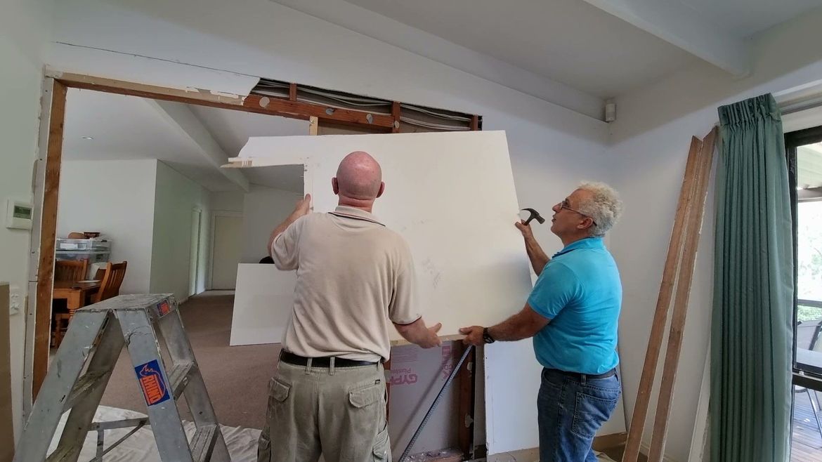

Step 3
Step 3: Cut out plasterboard and remove timbers necessary.
Step 4
Step 4: Turn the electricity supply off if wires are present!!!
Step 5
Step 5: Re structure the timber studs & beam appropriate to the opening size that will carry the loads required for your opening size.

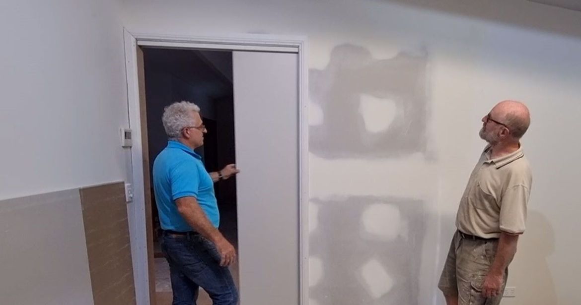

Step 6
Step 6: Install the internal cavity sliding door in place using an accurate level!!!
Step 7
Step 7: Fit off the wheels provided & install the internal hollow core door, making necessary adjustments.
Step 8
Step 8: Place & Fix plasterboard to close off the wall & then set.
Step 9
Step 9: Install the timber pelmets to both side of the opening to finish off.
Step 10
Step 10: Measure, cut & install architraves around the cavity sliding door jamb.
