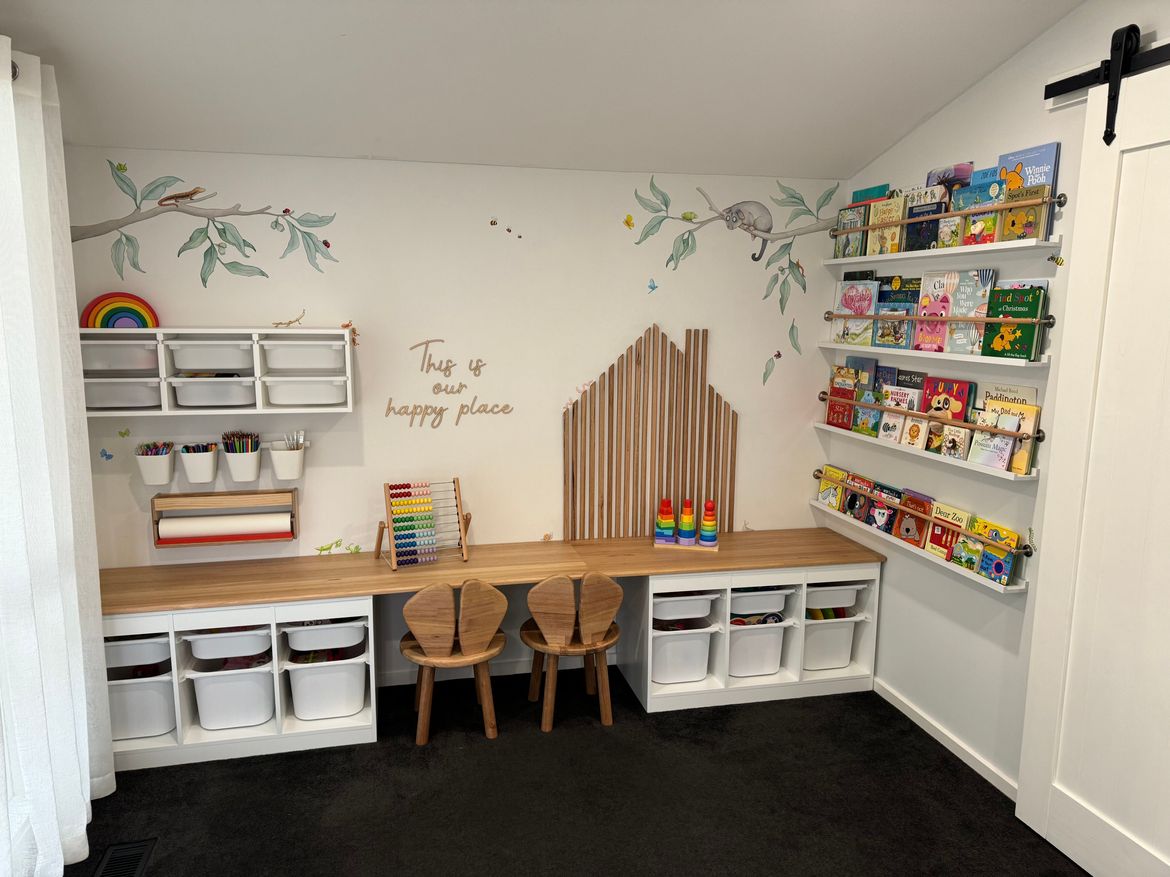

Kids playroom with storage, Bunnings bench top, and a bookshelf. Also made two cute little kids chairs to go with it.
Materials
Bunnings table top x 2
Hard wax oil
Screws
Dowel
Brackets
Wood glue
Biscuit joiners
Storage cubes
Kmart floating shelves
Tools
Makita drop saw
Makita impact driver
Makita power saw
Makita drill
Orbital sander
Biscuit joiner
Steps
Step 1
Got storage cubes and Kmart floating shelves.
Step 2
Joined two bench tops together with glue and a biscuit joiner and some joiner plates underneath as I needed extra length. Then sanded and coated it with a hard wax oil.
Step 3
Cut up strips of timber left from cutting one of the  bench tops down and rounded the edges then cut the ends on a 45 degree angle to make the timber house on the back wall.
Step 4
Added dowel and curtain rod ends to the front of the floating shelves for books to stay on the shelves.
Step 5

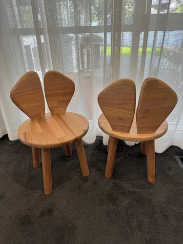

Made the 2 little kids chairs out of vic ash timber - cut 2 big circles and 4 seat backings out. Added dowel for the legs with furniture leg brackets and sanded it all and coated with hard wax oil.
Step 6
Added decals to the back wall
