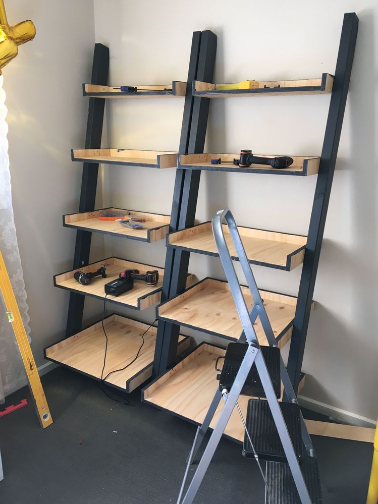

Ladder shelves with plywood and 90x45
pats6182
Junior Contributor
5B5EBF65-2659-4038-BC59-6A7FA5E23D61$L0$001~photo#20210414T043004Z.JPGLadder shelves with 18mm plywood and using 90x45 for the frame. Painted the frame black and the edges of the plywood.

Thank you for sharing such wonderfully made ladder shelves. Did you build it from scratch or did you base it on a plan? Will you be sealing the exposed timber shelves with varnish? Any information or advice you can give would be much appreciated by our members.

Hi @EricL
Yes I did built it from scratch. I needed custom size and wasn't able to source the size I needed.
Used one sheet of 2400 X 1200, got it cut to size at Bunnings and then assembly was easy as. Shelves were made using pocket hole screws. I did apply two coats of varnish.
