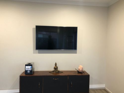

So I have decided to spend some time on bringing some color and feature into our living room TV wall. It is quite boring right now with just a plain wall and TV hung up on it and what we would like to do is make panel feature on the wall through squares or rectangles and then paint it with deep blue or ocean green (yet to be decided) colors to make it pop.

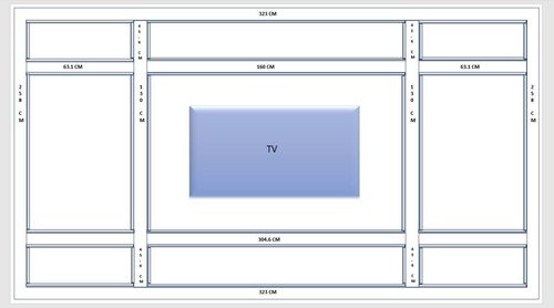

We locked in on a design - a sample sketch attached and we are maybe a quarter way through and awaiting stock at Bunnings to complete the rest.
Please let me know what you think of this and if any suggestions.

Rough Sketch
Before commencing project

Hi @ravit,
Many thanks for the update. It looks like you are doing a fantastic job there.
There is nothing I can offer advice wise that I don't think you are already covering. I like that you have added the internal mouldings and that is what I would have done. Make sure you go back over with a timber filler and cover those gaps. Creating perfect mitres can be difficult and taking the time to fill the gaps and sand will be worth it. I am sure you were intending to do that anyway.
