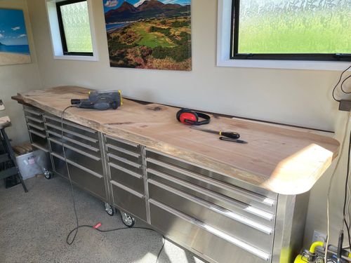

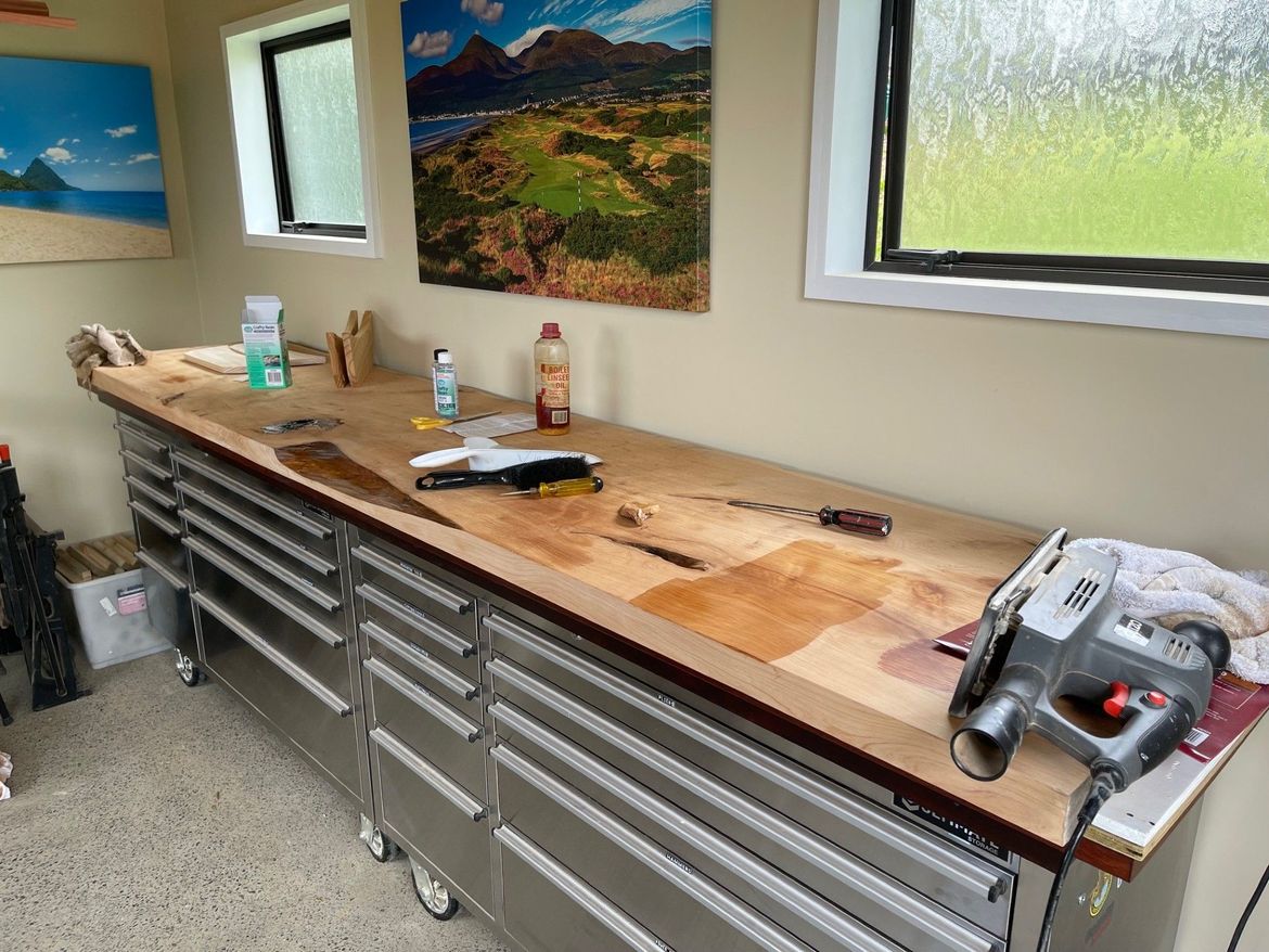

Select the location for your bar leaner and a timber slab that will fit in the space. In this case, the slab was to fit between 2 posts but that meant cutting the slab so the posts would be 'in' the timber - more on that later... Round the corners and sand with the finishing sander and 180 grit sandpaper

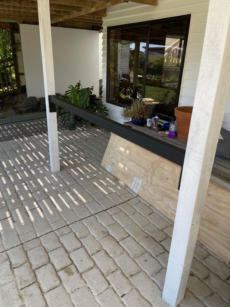

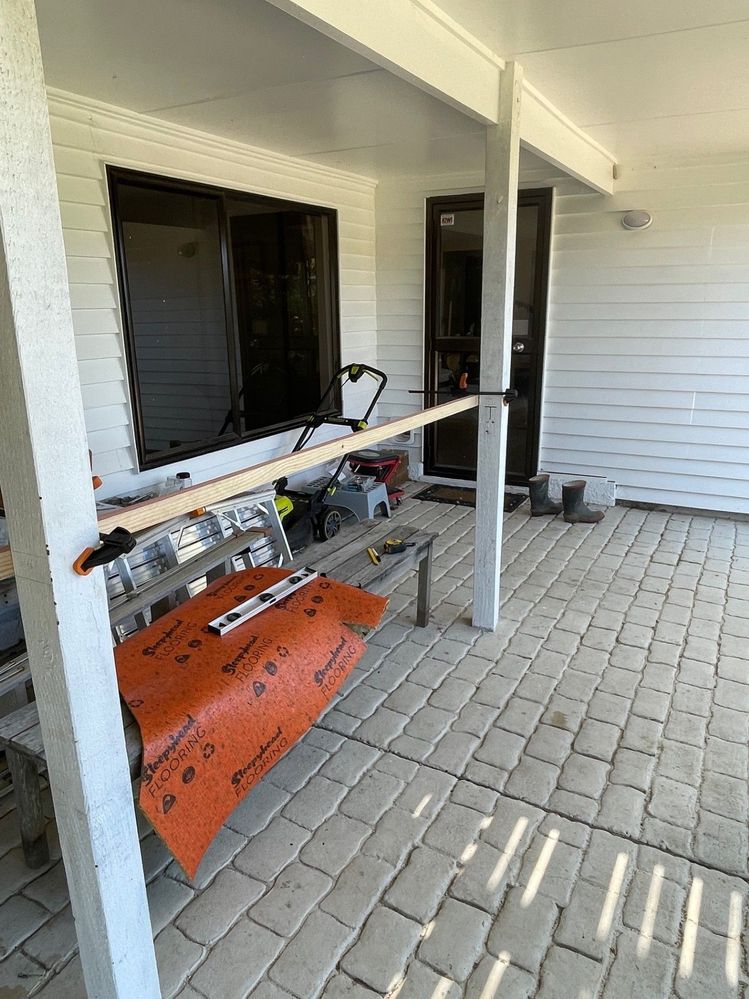

Prepare the area where the leaner is to be installed and confirm all measurements. I had a welder friend make a galvanised steel support beam according to specs I provided but a solid timber beam would also work. The timber slab needs support to cover a 2 meter span and the steel or timber beam provides this...

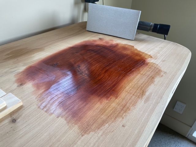

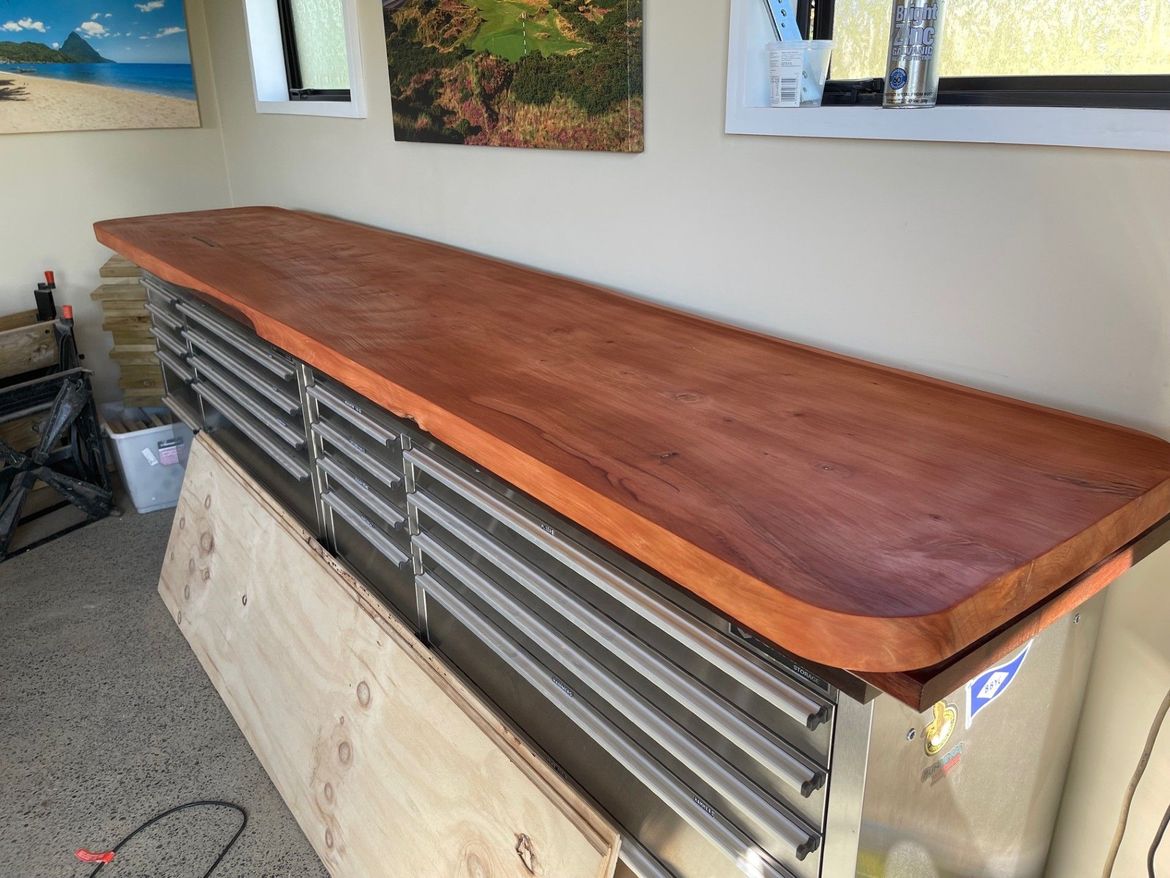

On the underside of the slab try different colors and finishes to ensure you'll be happy with the finished product and you're comfortable with the application. I chose Jarrah stain and high gloss epoxy resin.
Step 4
On the slab face side fill any holes with Crafty resin and apply the stain. The resin won't be applied until the slab is installed.

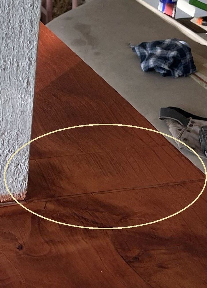

Instal the slab by cutting slots for the posts to slide into. Keep the pieces removed as they both need to be glued back in once the slab is installed over and attached to the support beam. The galvanised straps are screwed in underneath to keep the slot pieces in place. Some timber strips are needed to fill the gaps left by the saw cuts.

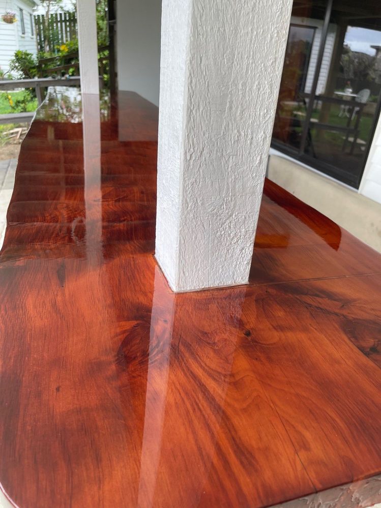

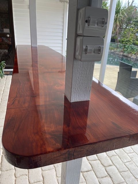

Apply the epoxy resin. This takes some practice. I needed to apply a sealer as an interface between the solvent-based stain and the epoxy resin. Touch-up any paint over-runs on the posts.
All done. Next steps; cabinet, bench and fridge on the wall side along with mood lighting over the leaner itself. And finally... some celebratory drinks with family and friends - we might sneak in some beforehand though:)

I absolutely love live-edge timber slabs. They really put the grain on display and show off the natural beauty that is hidden inside every tree.
The jarrah stain makes the grain look even more fantastic underneath the high-gloss epoxy resin.
I've also got to mention the fantastic job you've done concealing those cutouts. If you hadn't pointed them out, I don't think I would've noticed.
I hope you enjoy a few beverages on your new lean on bar.
Thank you for sharing, it is brilliant.

Now that looks like a nice benchtop, love the glossiness.
The cutouts you have and then reinstalled are next level :smile: I know I would have ended up with a not so smooth outcome.
