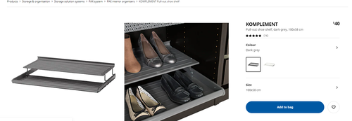

Just read that you want to build your own desk, with a keyboard and mouse pull out tray, I found this on a Youtube video,

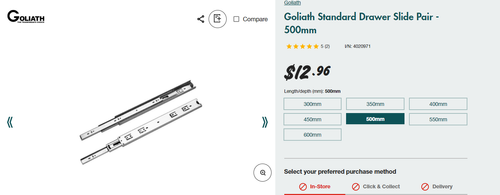

it's an Ikea pull out shoe shelf which can be easily modified to a keyboard tray. or you could buy 2 drawer runners from Bunnings and make your own, it's a bit more work where you have to make the tray and supports for the drawer rails, .@Ericl may be able to sketch a drawing for you.
Bunnings drawer runners.
