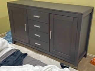

I changed this sideboard with drawers from gloss varnished wood to low sheen Monument.

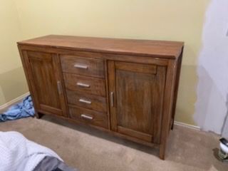

Step 1. Take a before picture (I usually forget this one…so this picture is actually after sanding…)

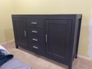

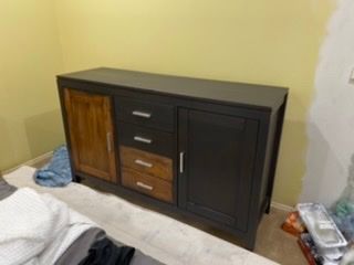

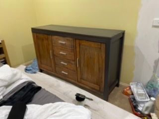

Step 4. Apply three light coats of paint with drying time in between. Remember that it takes about a week for the paint to completely harden so have patience and don’t rush to use it!!!
Step 5. Admire your work with a G&T or cup of tea and share your finished project with friends!

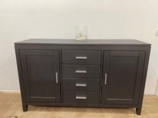

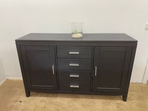

Update: This photo almost 2 years on. The paint is holding strong with everyday use, so overall I’m very pleased that the work seems to be lasting well!
