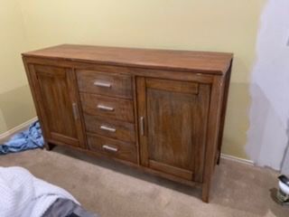

I changed this sideboard with drawers from gloss varnished wood to low sheen Monument.

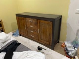

Step 1. Take a before picture (I usually forget this one…so this picture is actually after sanding…)

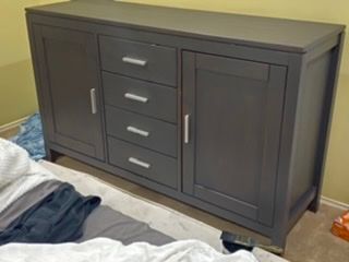

Step 3. Lightly hand sand with medium grit sand paper. Use ear muffs if you are using a sander, the podcast earphones still work under them. They are much cheaper than a hearing aid later 😆
Step 4. Use masking tape for the edges. Remove the handles (and replace them with new ones) if you like.
The handles on this were good, although I’ve removed and replaced handles on previous projects. In fact, I didn’t even remove the handles on this on….
I was keen to just start the project, so I  just used kitchen towel or baby wipes and clean any paint splodges as I went instead.
I find that although some of the preparation work is essential for a good result, getting started (and finished) is the important thing!

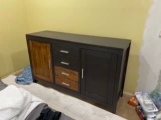

Step 4. Apply three light coats of paint with drying time in between. Remember that it takes about a week for the paint to completely harden so have patience and don’t rush to use it!!!

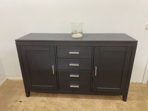

Update: This photo almost 2 years on. The paint is holding strong with everyday use, so overall I’m very pleased that the work seems to be lasting well!
