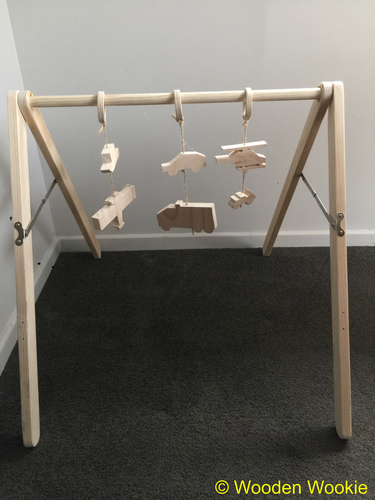

Finished productFinished product
It's taken me a while to post this no thanks to last week being a heavy week at work. I had made this for my brother in law's baby but it never made it to them because they already went and bought one. I'm going to make another one of these though because there are a few mistakes on this one. It's being used as a prototype now.

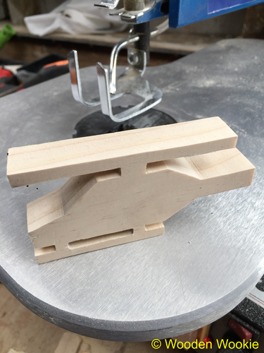

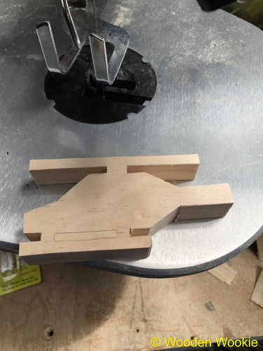

HelicopterHelicopter
Thanks to scroll saw and drill I could cut landers outThanks to scroll saw and drill I could cut landers out

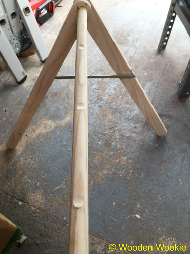

Using a half round file I made slits that the rings could sit inUsing a half round file I made slits that the rings could sit in

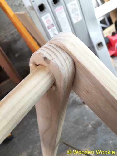

4mm pin to stop legs moving4mm pin to stop legs moving

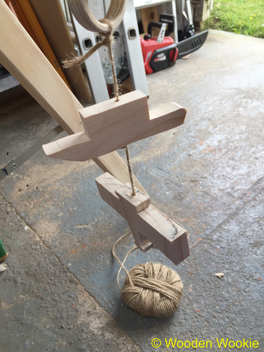

Boat and planeBoat and plane

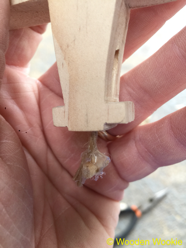

4mm dowel hot glued to string to act as stay4mm dowel hot glued to string to act as stay
