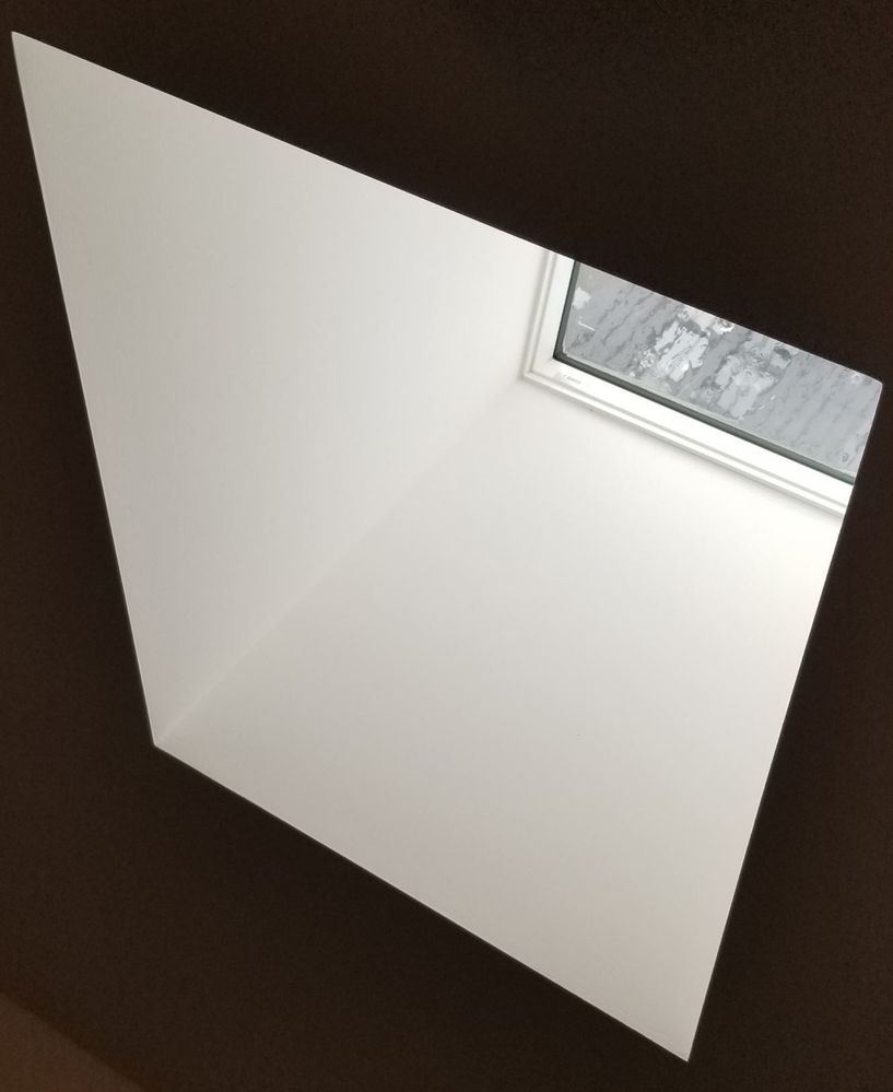

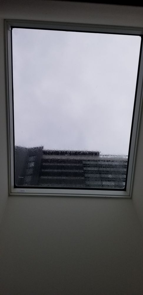

I would like to install a blockout blind for a skylight. It measures 92cm x 73cm.
What are my options for a DIY blind? What tools do I need to install one?

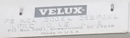

Hi Eric,
Yes it is a Velux. I have taken a picture of the plate attached to it:
Could you please help to check if there's a specific blind for it?
Thanks for sharing the extra detail @MBrisbois.
@EricL will be able to assist further when he is back online this evening.
I've just spoken to our provider, and I'm sorry, but they are putting all the blinds on hold due to a parts shortage. However, I did ask about your Velux model unfortunately, it is no longer available. I asked when the blinds were coming back into production, and they could not provide a specific date.
In my search to find you a skylight blind, I came across a D.I.Y. solution. You can use two towel rails in parallel to hold either a cloth curtain or sunscreen material. You then attach clothing straps around the towel rails to hold the blind in place. You can lower or raise the blind with a broom. I've placed a sketch below, please tell me what you think.
That's a great DIY idea, Eric!
Are the towel rails available in custom sizes, as in the size of my skylight opening?
Can you guide me to the links of what I need to buy from Bunnings to get this going?
