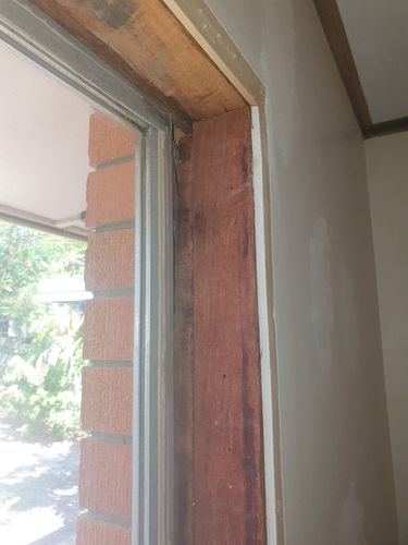

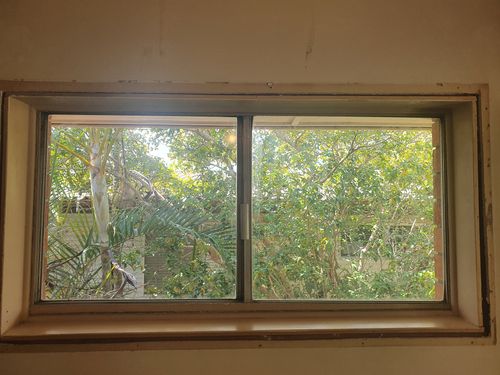

I'm having issues with the aluminium windows. Typical looking old aluminum windows. Dirty, ugly and would love to remove them.. only is is once I removed the architraves and quarter round from where the "reveals" are, I noticed the reveals were not normal and not attached to the window frame... can someone please tell me if the windows are set into the house frame or brick?! So strange.. I was hoping for a pull out window and reveal and replace with new aluminium windows that are better looking and clean.

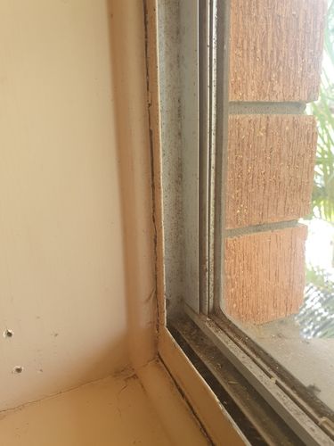

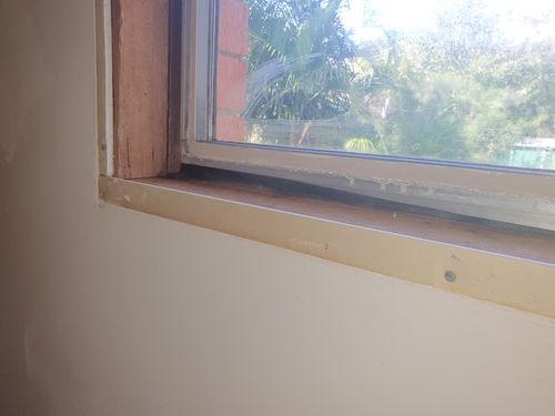

The fake reveals left a big gap (about 5-10 mm at times) between it and the aluminum frame. The framing is not straight along the top or bottom on multiple windows in the house and was unlevel compared to reveals which looked level when using a level,
so I was hoping to start by trying with a bedroom window on how I would go.

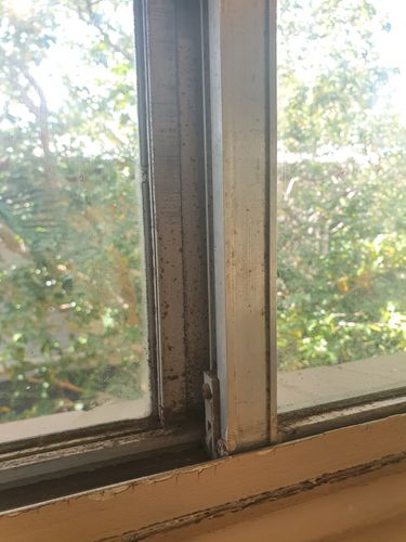

Even if I leave the windows in there, how to I level the framing or at least paint the gunky crusty frame which already has paint on them?!
Any advice is much appreciated

It appears that the window frames are boxed in with timber. The filler around the aluminium frame would need to be removed and you'll most likely come across screws or nails holding the window in position. Once it is removed you'll be free to install new windows and fix the reveal and fill any of the remaining gaps.
Let me mention @Brad to see if he has come across this situation before.
