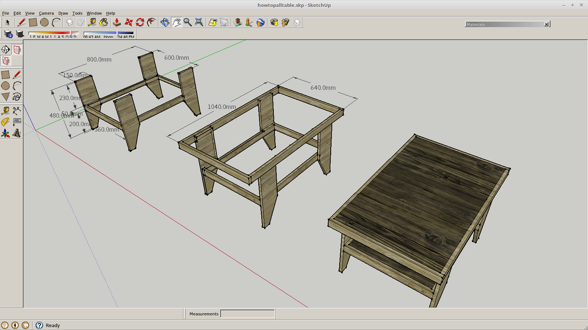

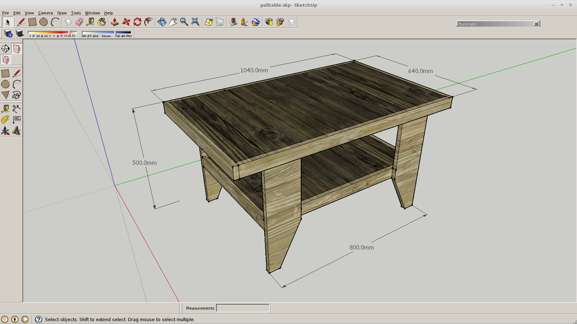

Hello @WCE2019
I have drawn you a nice simple pallet coffee table. The trick to this table is the finish. Using a random orbital sander you must polish the top and second shelf to within an inch of its life. Not to mention givng the legs a good sanding as well. after all the sanding and polishing The secret paint is a stain and varnish called "Black Japan Gloss", you must only paint the top and bottomshelf but leave the rest as normal. You can leave the timber bordering plain so that top pops out or do the entire surface, its up to you. Once the stain has dried you can cover the entire table with plain clear non yellowing varnish. If done properly you should get the effect I've drawn. This will test your patience and DIY skills. Goodluck and hope to see the finished product on the site!
Clean and simple. Your effort will give the table character.Clean and simple. Your effort will give the table character.Here is the starting frame.Here is the starting frame.The top frame simply needs to centered.The top frame simply needs to centered.

Fantastic plans as always @redracer01. Well done!

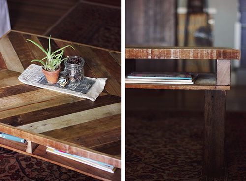

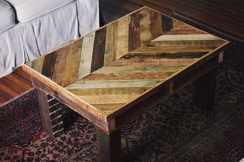

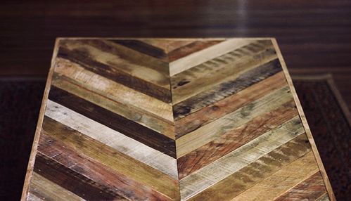

what are the joins used?
also,
could anyone tell me aprox how many pallets this uses?

The design I made for you uses ordinary butt joins. Where the flat side of a timber piece plainly meets the flat side of another. If you cut the timber in a 45 degree angle and join two 45 degree angle joins, this is known as a mitre join. There are many more types of angles and can be seen on any timber joinery web site. The drawing I made will approximately use a little over 2 pallets. Best thing to do is to disassemble the pallets and line them up to see where you need to make the cuts and how many parts you may need to complete the table. The picture you posted will probably use the same amount of pallets, but as i stated the best thing to do is to make measurements and do the math. You can also physically match up the pieces that you have to the design your are trying to emulate. Good luck on your measurements!
