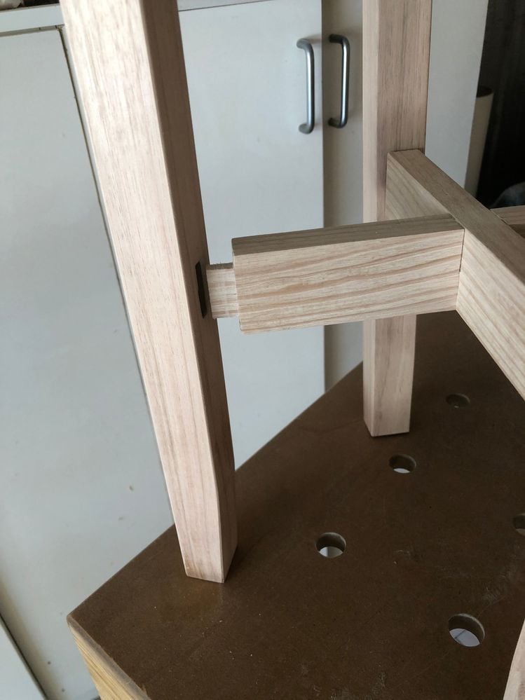

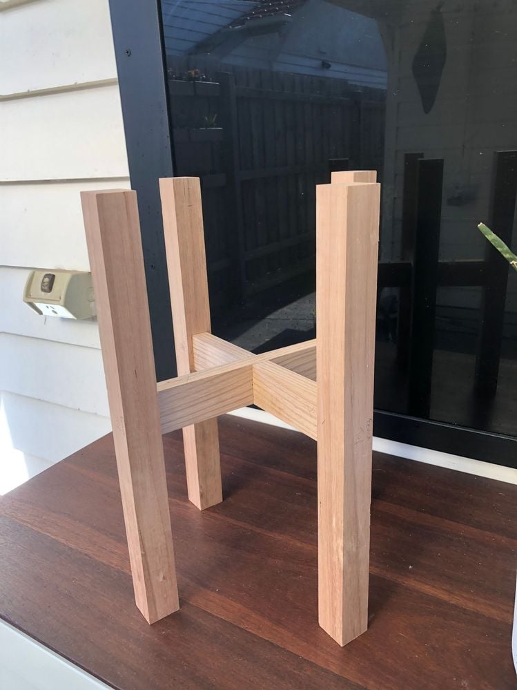

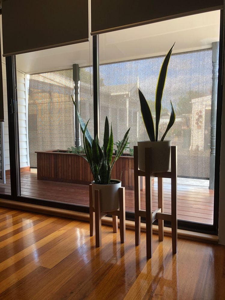

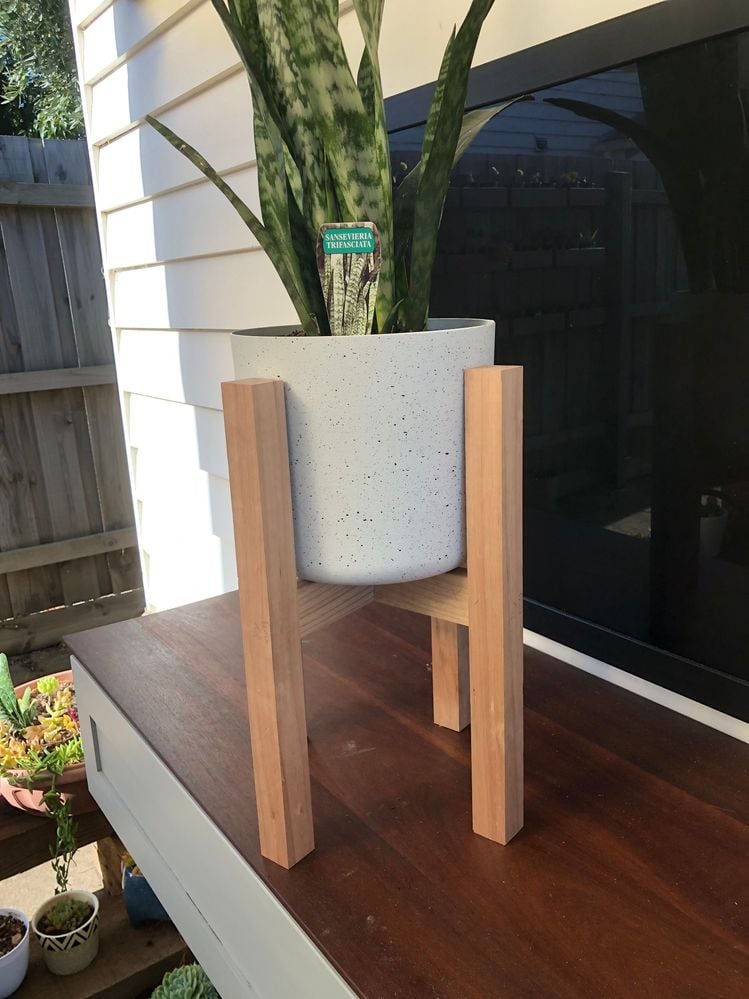

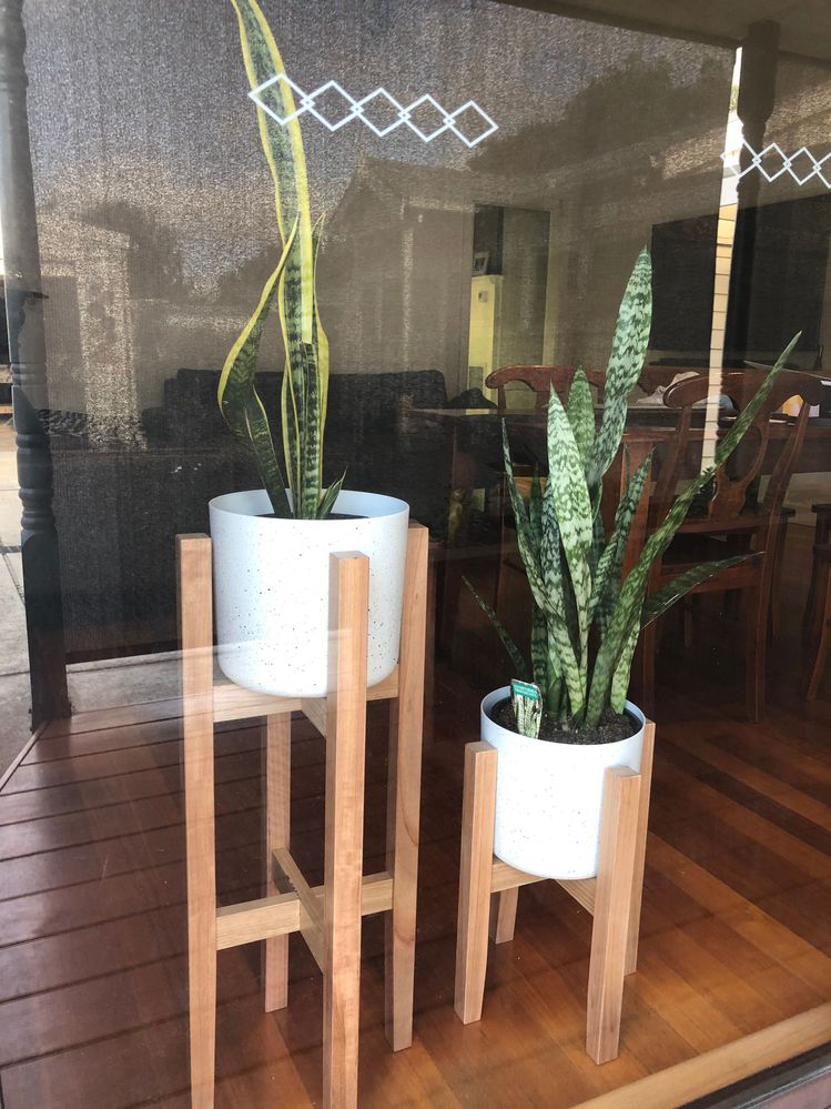

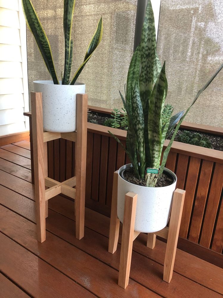

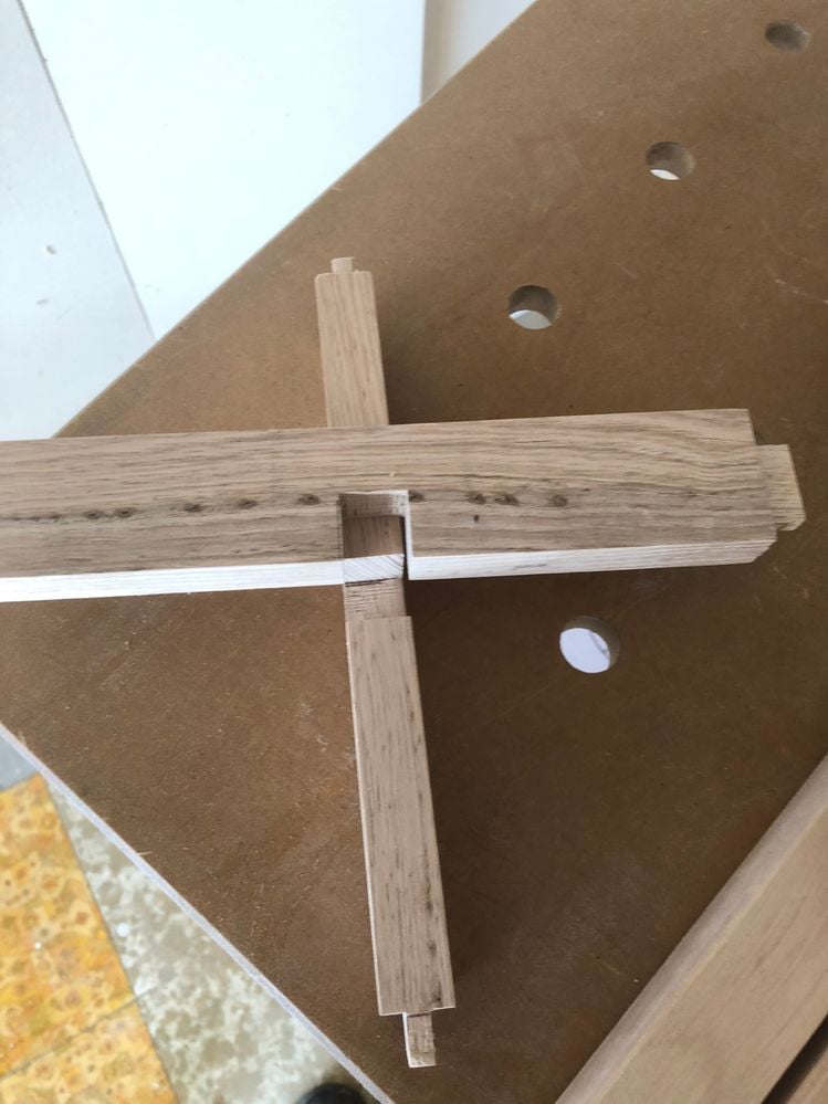

After being inspired by @joineryjo planter stands, I decided to make my own similar/same as @joineryjo .

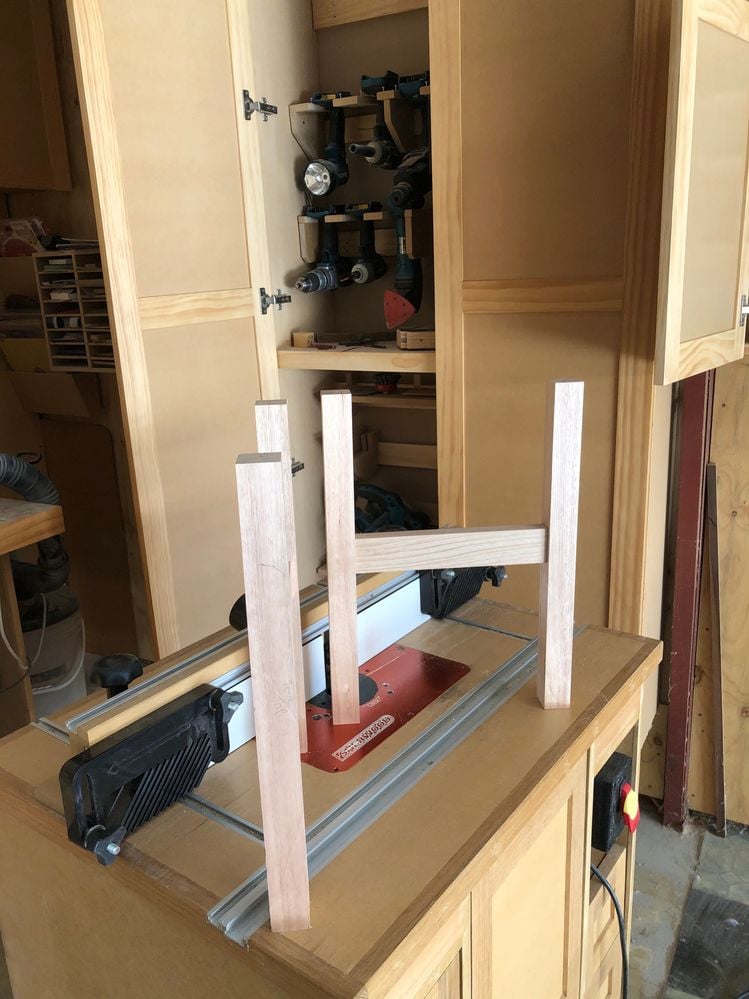

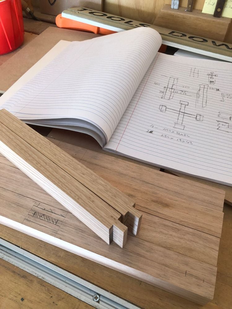

The only difference is that I used Tasmanian Oak, DAR, 32x32 mm for the legs and 42x19mm for the cross sections.

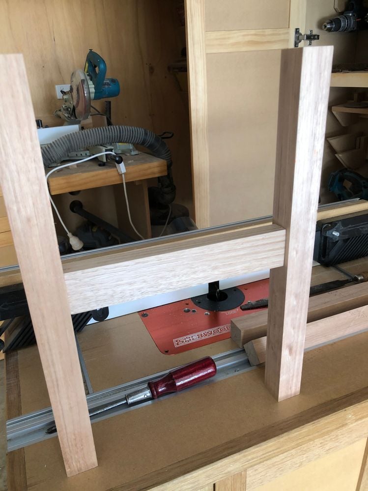

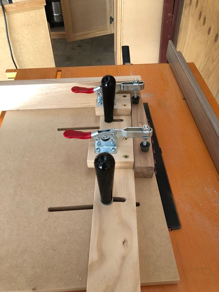

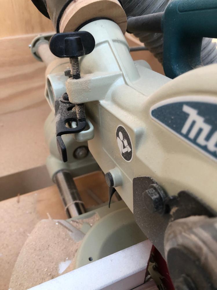

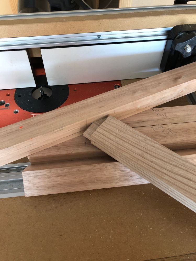

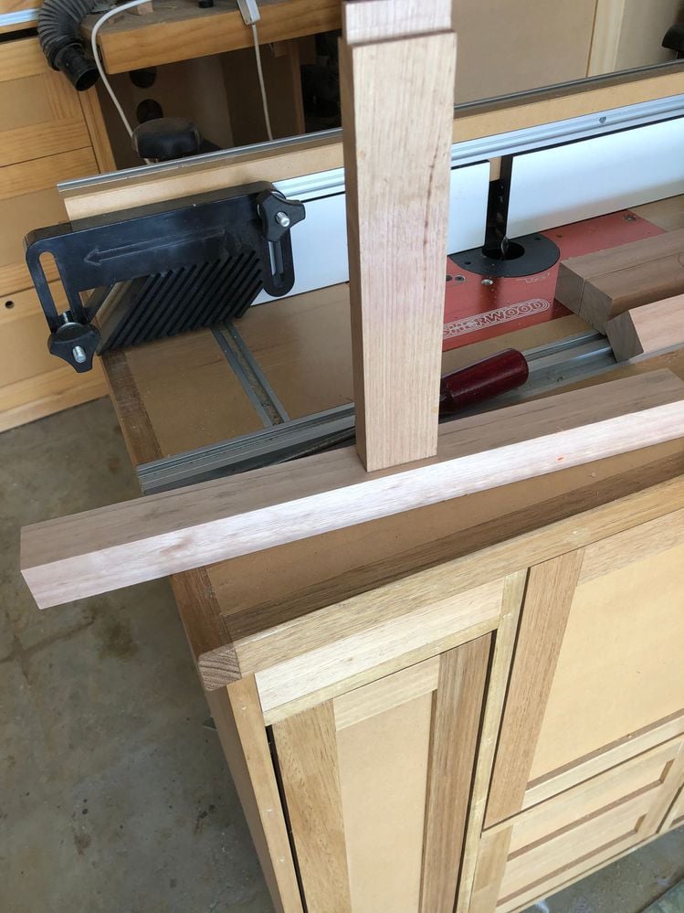

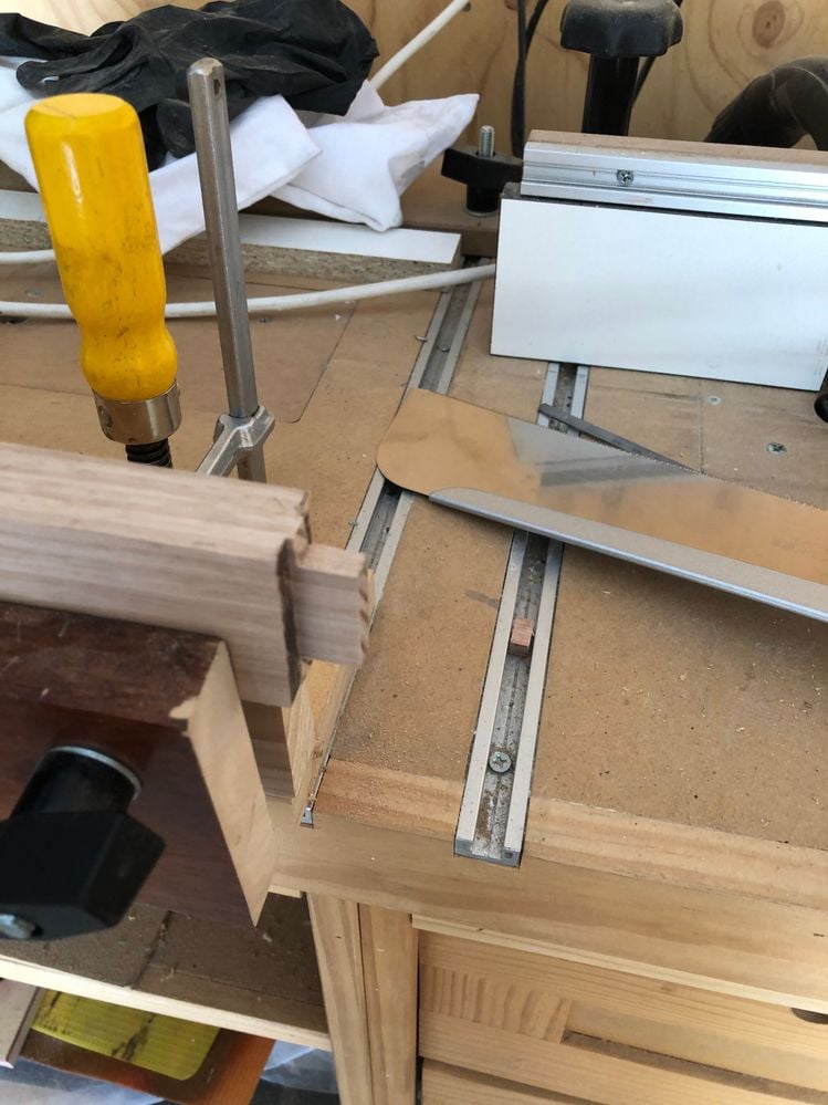

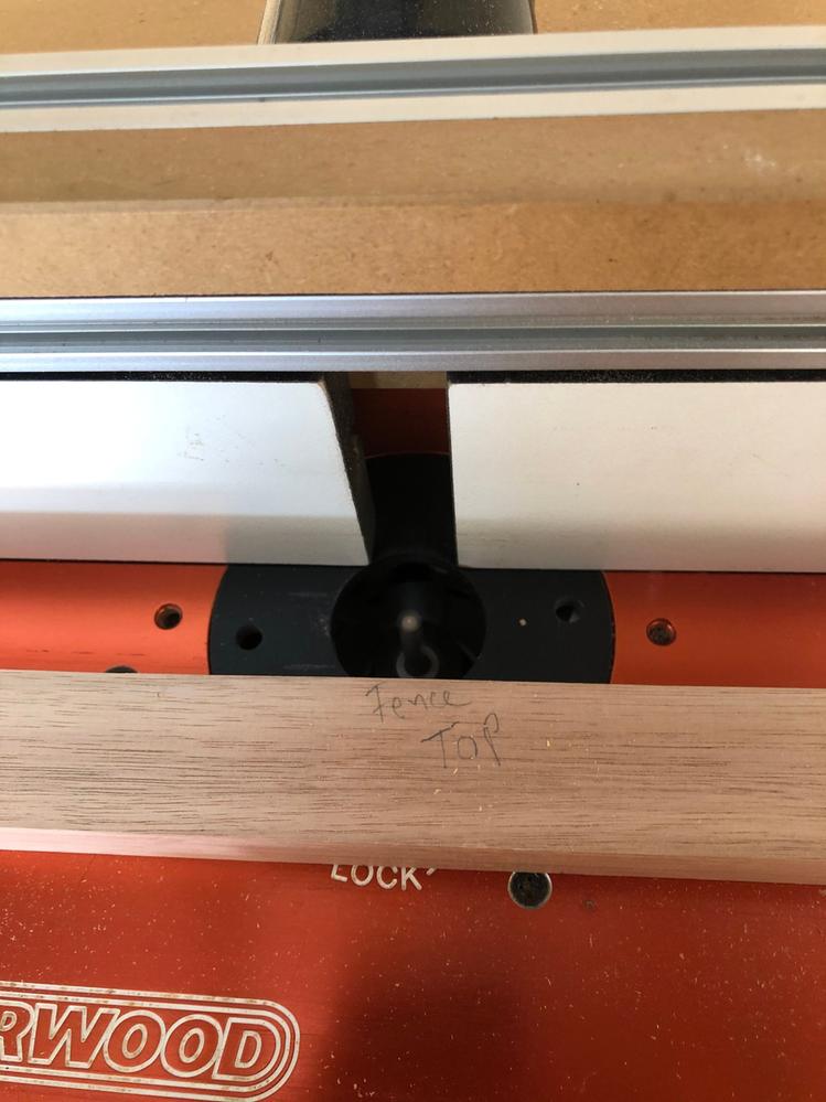

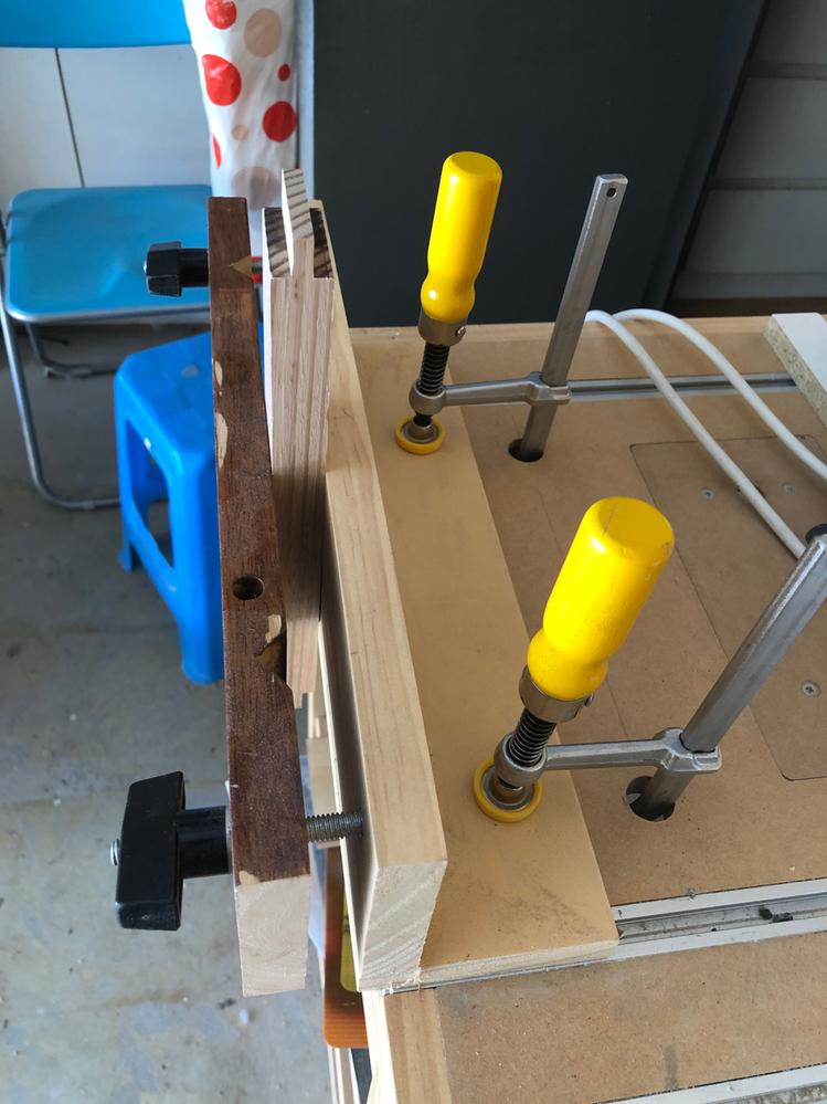

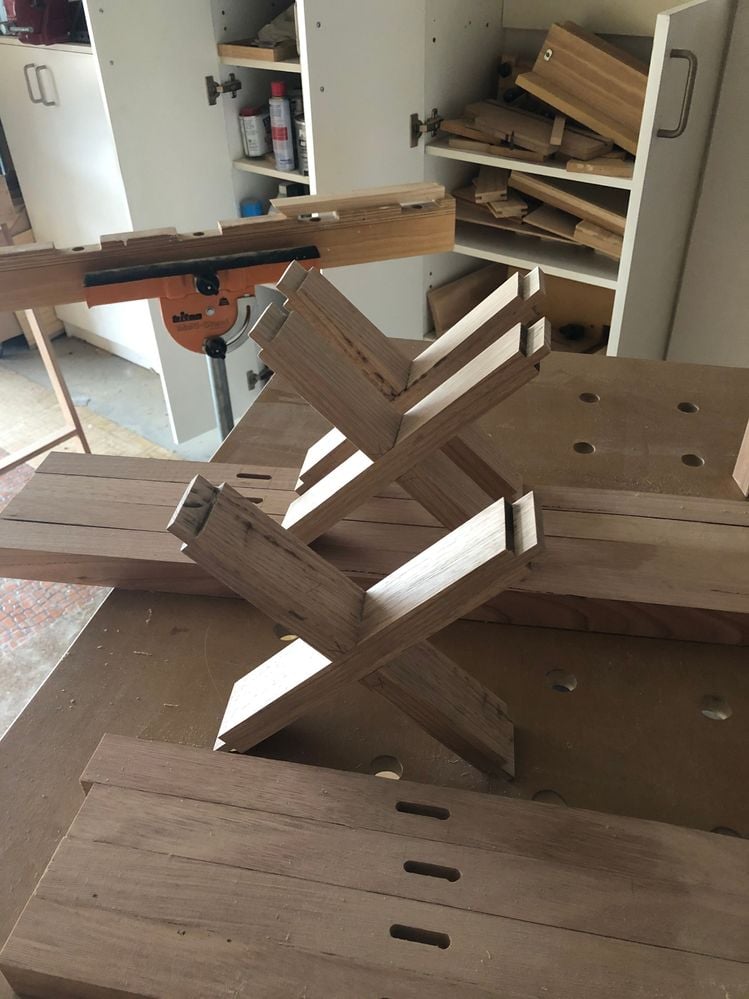

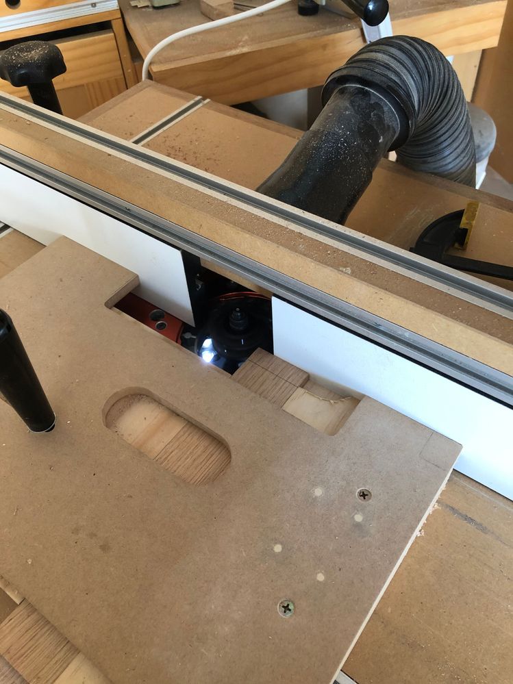

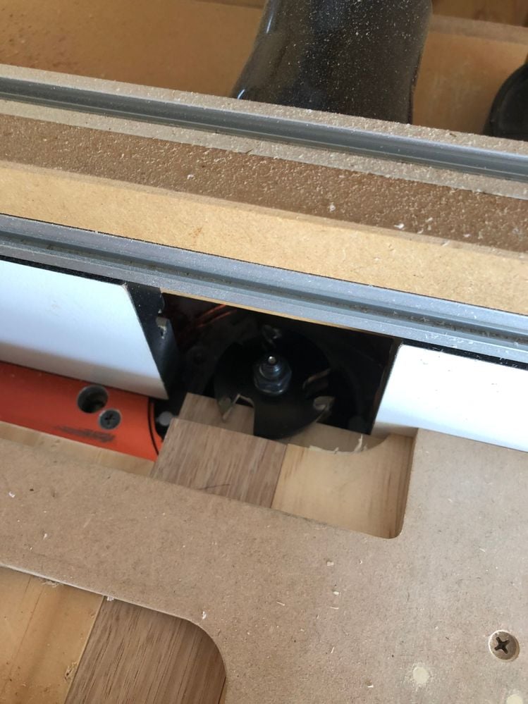

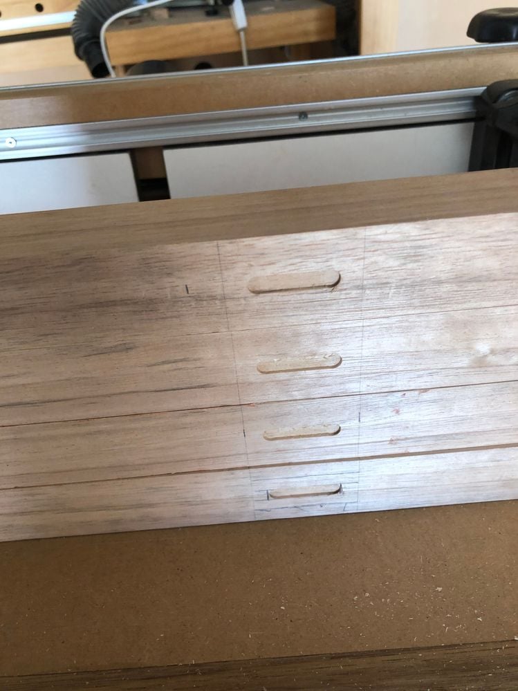

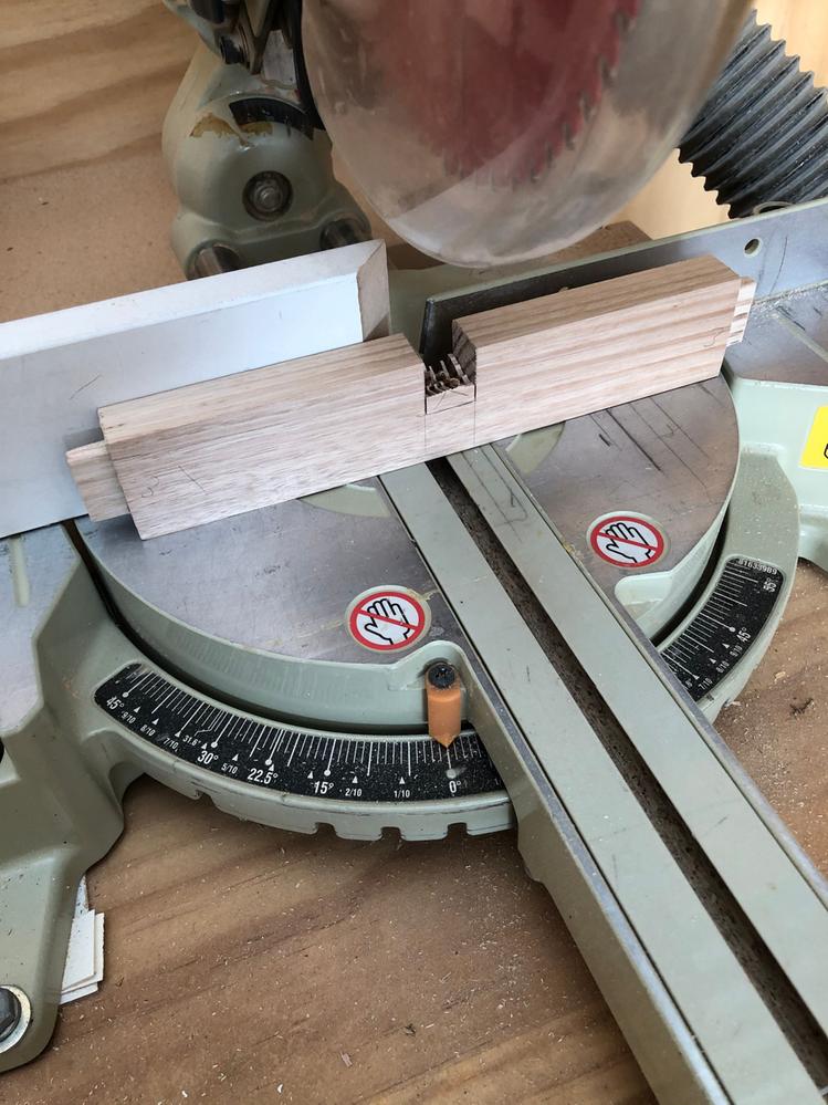

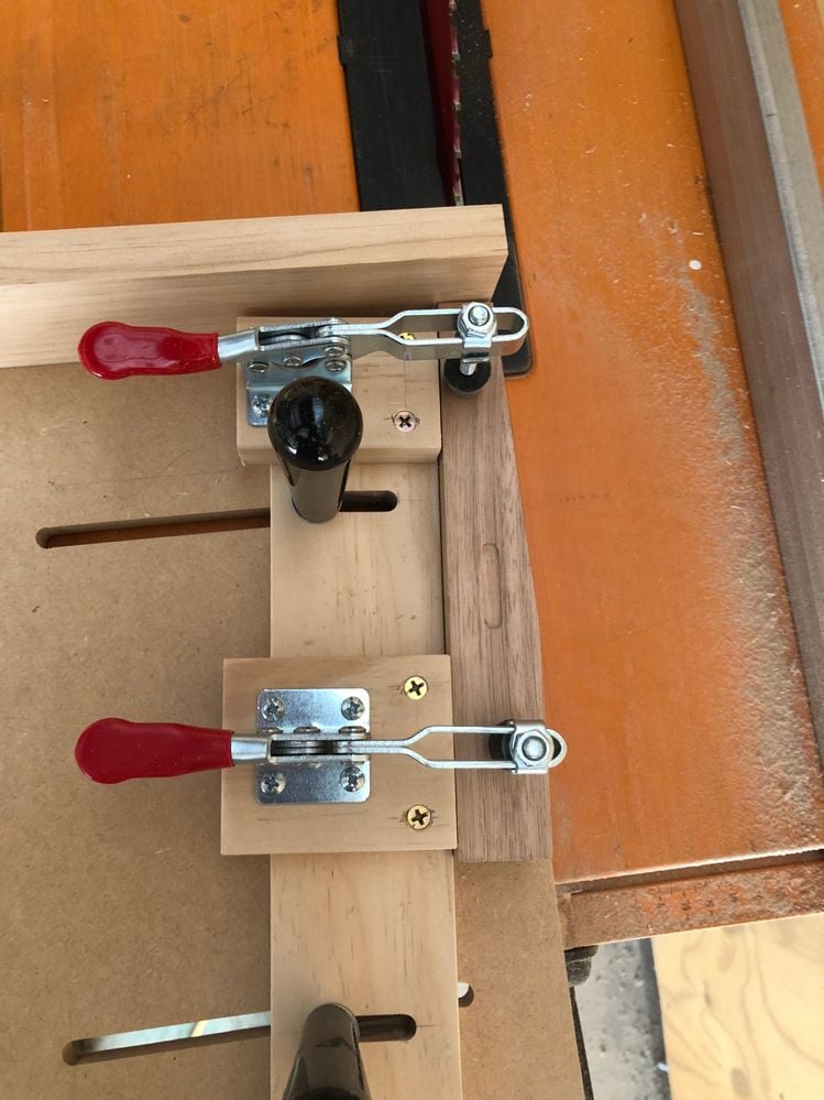

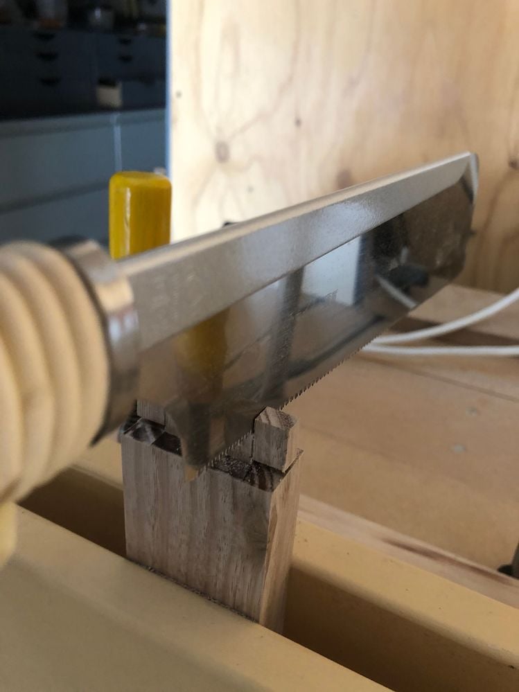

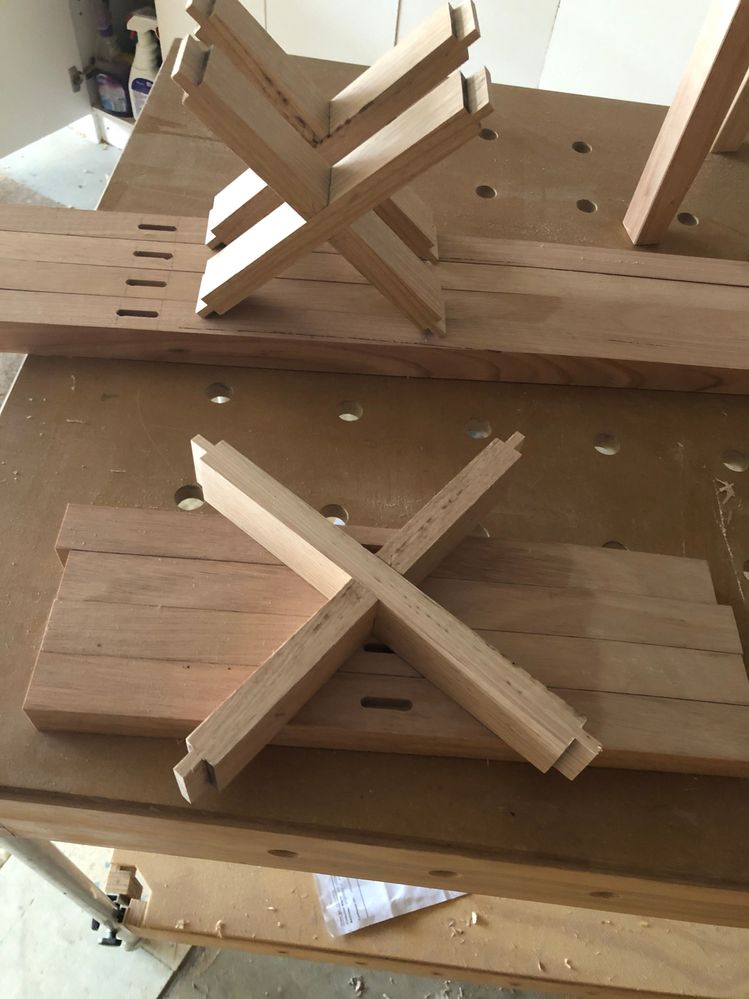

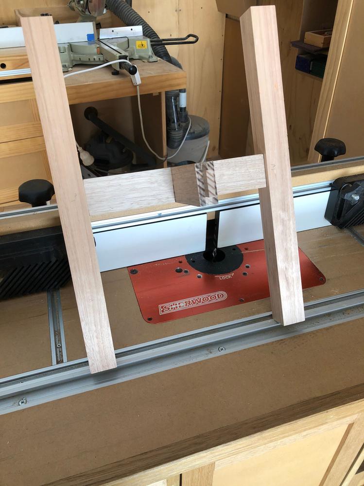

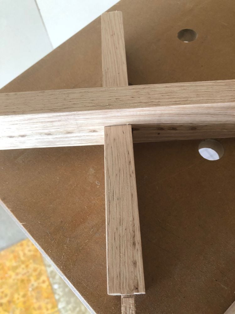

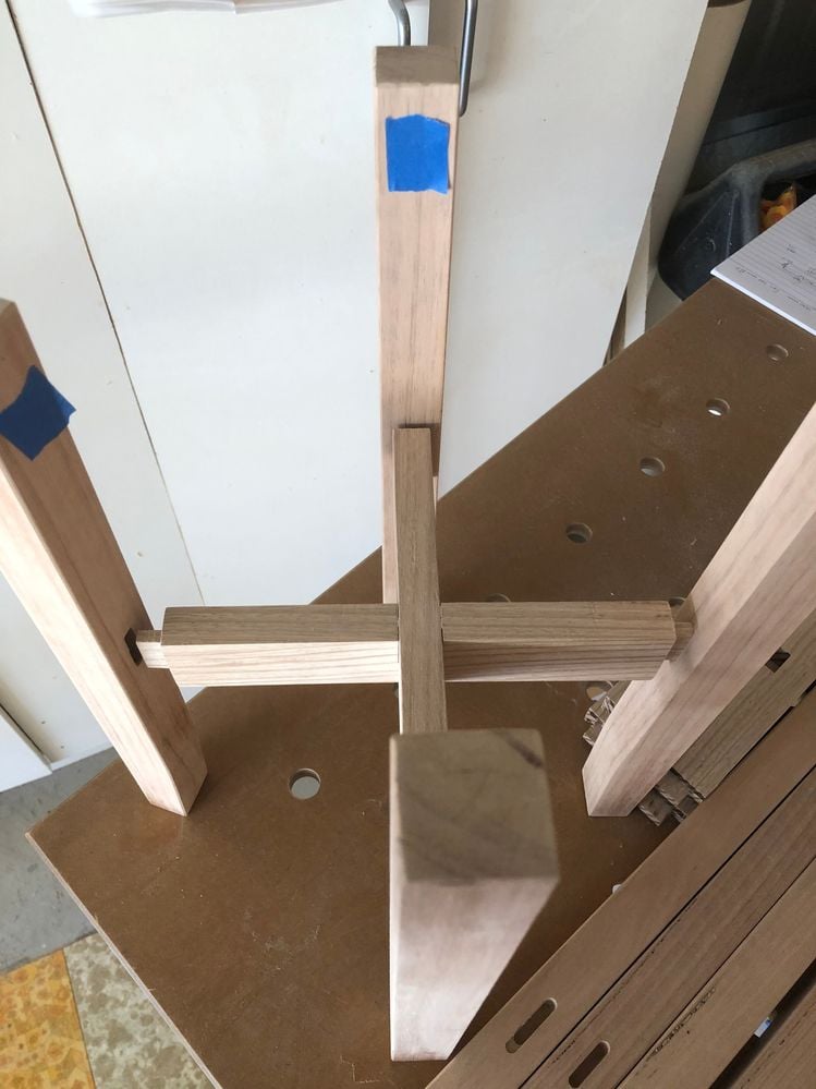

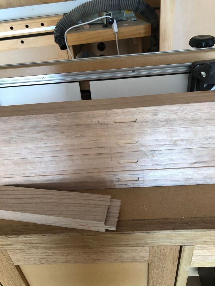

I also cut my own mortise and tenon, instead of screws, all the joints were glued with a water proof glue (Titebond 3), and added a slight taper to the bottom part of each leg, to do this I made a small taper jig for my table saw. For the cross sections, I cut the middle section out using a pull saw and chisel, however, I then set up my drop saw at the depth required and cut the rest that way, much easier and more accurate. The mortise and tenon's on each leg were cut on on my router table.

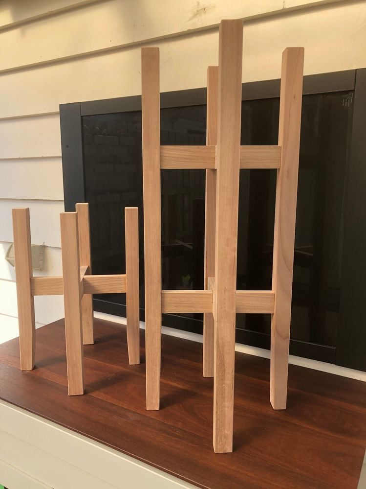

I have also made a third stand, however, not yet assembled, I need to buy the pot for it, this stand is slightly wider, the others will fit a 200mm dia pot, the third one will take a 250mm dia pot.
Please see photo's attached.
