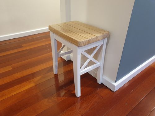

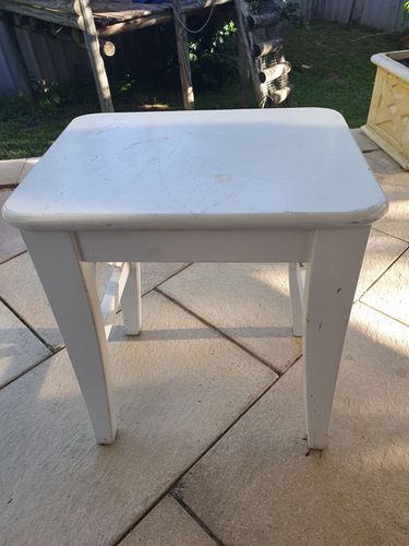

I found this small stool/utility table at vinnies for $10 and thought it would make a nice addition to our home. The frame was solid wood, but the top was MDF which had water damage.

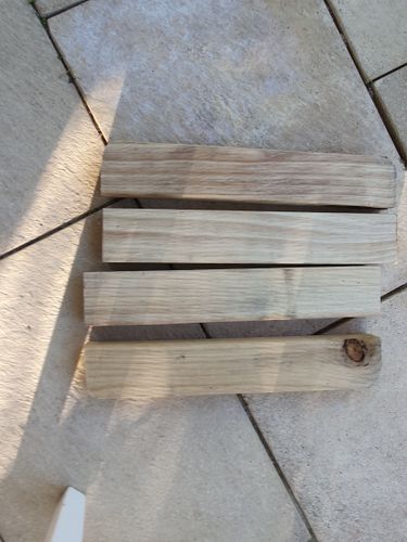

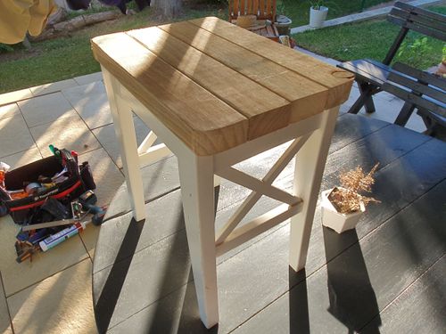

I replaced the top with leftover pine (non-structural pine) from a previous project and then painted the frame (Dulux white on white, Gloss). I fixed the wood onto the frame using Selleys Liquid Nails, sanded the surface with 80 grit then 220 grit, and applied three coats using a water base varnish (Timber Protect Gloss One Coat Clear Water Based Varnish).
It turned out pretty good and we get to recycled as well.
