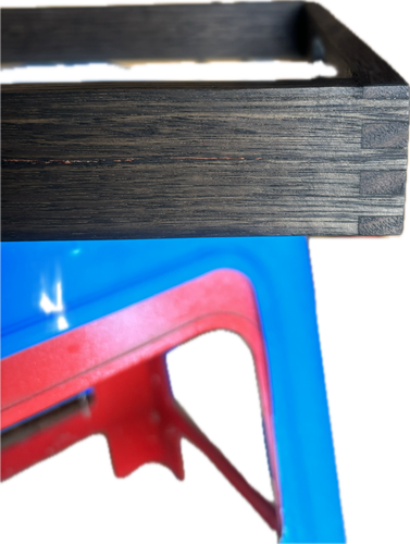

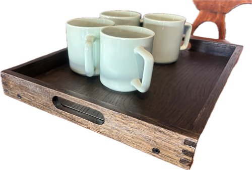

Cut tray sides to fit around the outside of the base. I cut out the slots for the handles using a jigsaw and router to cleanup, I made a template to get a neat finish.
I also joined the ends of the timber by making the joints as a box joint, then glued.

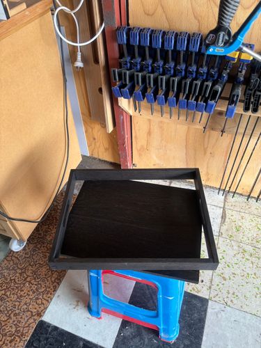

I sanded the sides and stained to match the base, I used Japan black stain and clear varnish
Step 3
Once dried, fitted the side to the base using black countersunk screws
