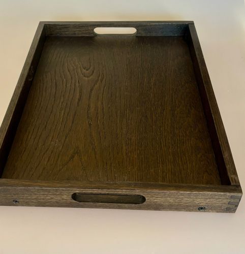

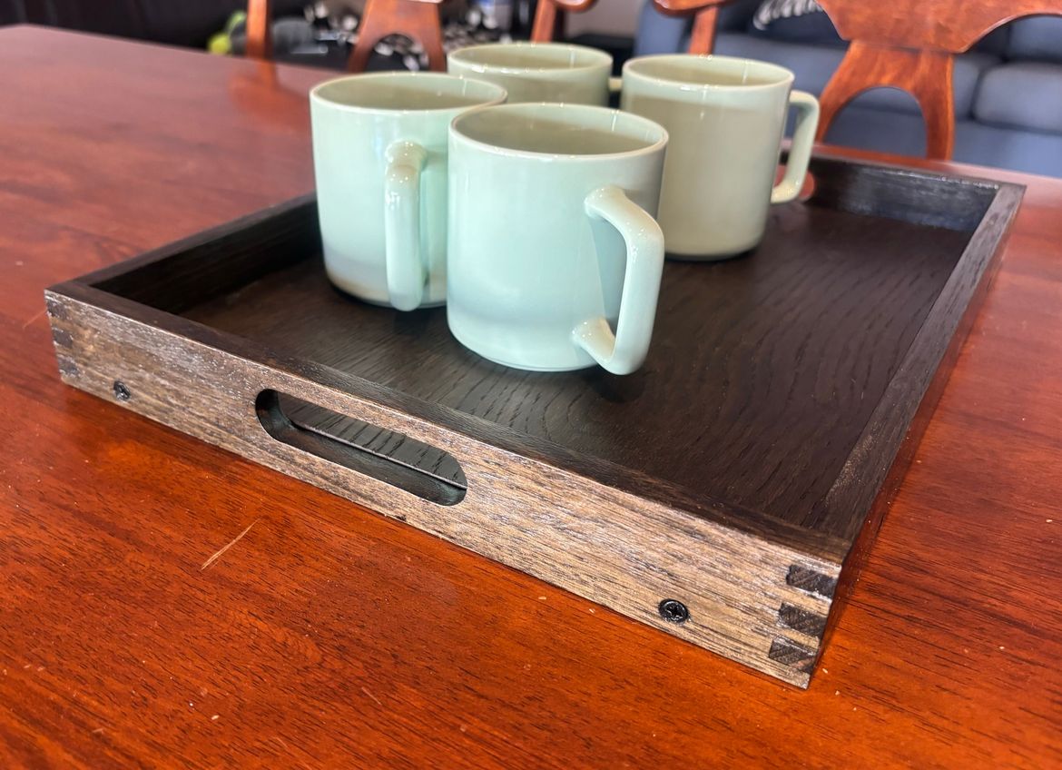

I made this serving tray using left over off cuts off floating timber floor boards and tas oak

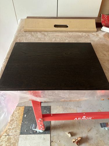

Cut floor boards to size of tray required
Glue boards to required width, mine is 285mm wide.

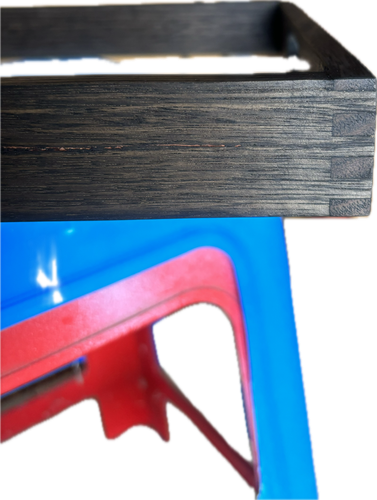

Cut tray sides to fit around the outside of the base. I cut out the slots for the handles using a jigsaw and router to cleanup, I made a template to get a neat finish.
I also joined the ends of the timber by making the joints as  a box joint, then glued.
I pre drilled mounting holes on the side rails
Step 2

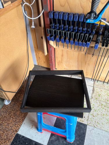

I sanded the sides and stained to match the base, I used Japan black stain and clear varnish
Step 3
Once dried, fitted the side to the base using black countersunk screws

What a neat project @JoeAzza, and a fabulous re-use of materials.
I love the efforts you've put into the joints and the overall appearance of the tray.
Well done, and many thanks for sharing.

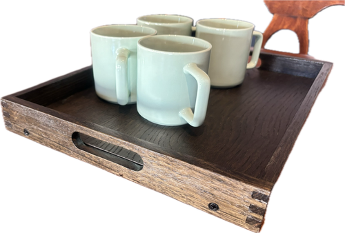

Thats a nice reuse of some leftover timber :smile: And must say I agree with @MitchellMc the effort you put into the joints fit properly is something Id like to attain one day :smile:
One project that will be used for years!
