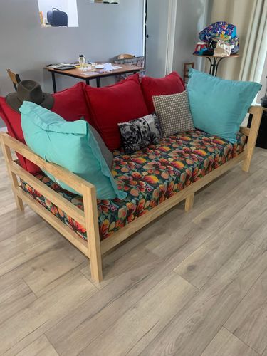

Simple daybed made with a spare single mattress I had at home. Doubles as a lounge/spare bed. All made with 70x30 pine dar and a sheet of ply as base support under the mattress. First time I used my kreg jig and definitely made the job easier. Still need to finish edges and paint but completely useable as is.  

Thank you so much for sharing your elegantly designed daybed. It looks very professionally made as you can't see any screws on the outside assembly. I've been thinking about getting my own Kreg Jig Kit but can never decide if I should buy a single piece or full set. Which one did you use for your day bed project? Will you be painting this in a dark colour or perhaps a natural finish? You would get excellent contrast against your floor if you paint this in a dark colour. Any tips or advice you can share with our members wanting to emulate your work would be much appreciated.
Would it be possible for you to post a photo of the inner corner of the daybed assembly? This will give our members an idea of how you joined the pieces together. Despite it looking straightforward knowing where to anchor your timber is important. Space allowing, I've always thought that a daybed is so much more practical than a sofabed. I'm sure this daybed will get a lot of use.
If you have any other projects on the go, please don't hesitate to share them. We look forward to seeing your daybed painted.

I am planning on painting in the Milk Paint Eclipse which is a dark colour. My lovely light floating timber look flooring is also from Bunnings!
I have this kreg jig: https://www.bunnings.com.au/kreg-pocket-hole-jig-320_p0202875 and it has the settings to make spaces perfectly for any size timber so no guessing on the best anchor points. Would highly recommend trialing on a few pieces of scrap timber to get the hang of it and good clamps are a must! Also making sure you use the correct size kreg screw - the instruction book in my set outlined everything because I had no clue even where to start connecting until I read it. It outlines all the measurements, adjustments and sizes for you.
For the back cushions I brought 2x euro sized cushion inserts for each single case to make them nice and fluffy to sit against.
