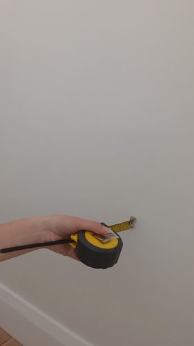

First I measured up the space I had behind the door, to understand the length of my shoe rack, and how much width I could get away with that wouldn't obstruct the door from opening. For me, this worked out to be about 80-100mm width and up to 800mm in length.

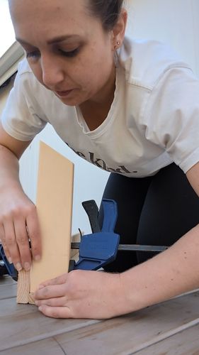

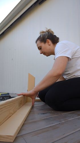

Then I gave my timber a sand, and started to assemble the pieces.
Base (60mm wide piece), connected to the two edge stripes, and a 90mm wide backing piece. I used PVA to hold the timber in place, and then added some trim nails using my nail gun.
I then added a top back panel (90mm wide piece) to the top of the edge strips, as well as a front strip using the same method.
I also used clamps to hold the timber in place if it was slipping.

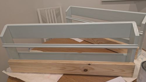

Once the glue had dried, I used a tiny bit of timber filler to cover the nail holes, and did another light sand before adding the paint.
For the majority of the shoe rack I used a primer and then top coat of h20 enamel, but for the front pieces of timber I decided to go with a clear varnish.

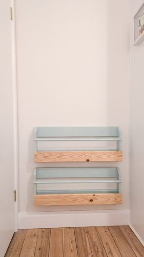

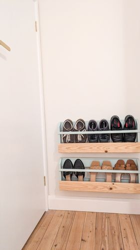

Once the paint and varnish was dry, that was it! I mounted these on the wall behind the door, and NO MORE SHOES ON THE GROUND!
