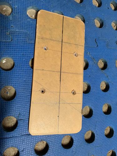

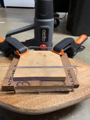

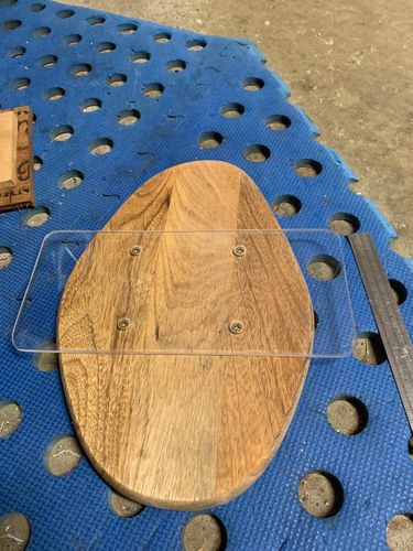

Quick little build today. I made a slide on armchair coffee table to hold my coffee cup or glass of wine.
I use a cheap little cutting board and perspex and a few screws. I just bent the perspex to fit the width of the armchair..

The trouble making them the sell, all lounge chair armrests are different sizes. The perspex was flat and I just used a heat gun to make it warm enough to bend the right size for my lounge.

I was thinking what can I use as I only have 2 boards and could not match the wood and then I thought of perspex, I is there but its not, all at the same time.

Hi Remarka6le Just a few build photos for you to show how I used the perspex, hope this helps.
