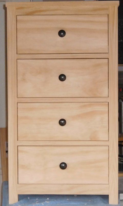

Just a small set of drawers made for a friend out of Bunnings' premium pine:

Great job @Bundaboy! Many thanks for sharing.

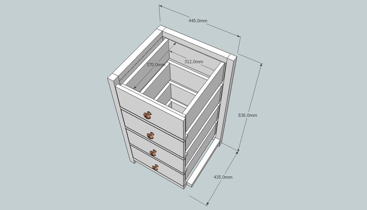

Hi is there a plan for the draws?

Sort of, but not detailed, I generally just knock up a sketchup drawing with the major dimensions and make the rest up as I go along, I think the only thing missing is the drawer bottoms which are 1/4 plywood floating in grooves either side of the draw box and the front, and screwed at the back - pretty much a stock standard technique for drawers.
If you are familiar with sketchup you could certainly work it out I think, it's all to scale so the dimension tool will give you everything you need.
Happy to make that available if requested

@Bundaboy
Am just starting out new to all the diy
It would be great if u can..thanks

@Flying-phonixAaaah I had forgotten that we can only post images (and videos) (that's right isn't it @Jason ?)
But never fear I can paste a link I think (I'm a poet but don't know it):
https://tinyurl.com/sj35c7c

I cant open the file

What is the error message? What version of Sketchup are you using?
Re: Small set of drawers
@Flying-phonix
You need to use this program - https://www.sketchup.com/
A free version is available.
