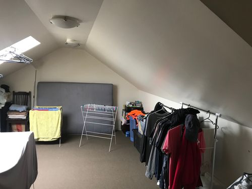

Hello @diydiva
Welcome to the Bunnings Workshop community. It's marvellous to have you join us, and thank you for sharing your question about storage solutions.
In order to give our members a better idea of the space you are working with, would it be possible for you to post a photo of the room?
Once we can see how things are arranged in the room, we'll be able to offer recommendations on possible storage configurations.
If you need a hand posting the photos, please let me know.
Hi @diydiva,
As Eric mentioned, if you could please share some photos of the room so our members can see what you are working with, I'm sure it would help a lot to receive more helpful and specific advice.
Could you also please tell us whether the storage system would only be temporary, or whether you might consider a built-in wardrobe? Built-in storage typically becomes a big asset for any home.

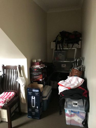

Hi @diydiva,
I'd recommend turning the alcove into a dedicated storage area and avoiding adding storage in the pitched roof section, as any storage added there will not be an efficient use of space due to the roof. It will also take away from any floor space that could be used to furnish the room. I'd propose you either build or purchase tiered shelving to suit your containers. It looks like there might be enough room to fit the shelving along one wall and still allow access to the area. This would be terrific as you could then add a partition wall and door to enclose the area. I've created the below renderings to give you an idea of what it might look like. You'd then have the entire room to decide where you'd like to place your desk.
Let me know what you think, and I'd be happy to provide further information or answer any questions you have.
Hi MitchellMc,
Thank you for your great ideas and the time you spent to help.I appreciate this and will start measuring out the space to see if it suits my needs.
Diydiva.
Keep us updated, @diydiva, and please reach out if you need assistance. If you have some other ideas, I'd be keen to assist you with implementing them.
Here's a series of videos that will assist in constructing the wall and installing a door: How to build a stud wall, How to install a door jamb, How to plasterboard a stud wall and How to hang a door.
