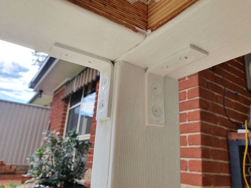

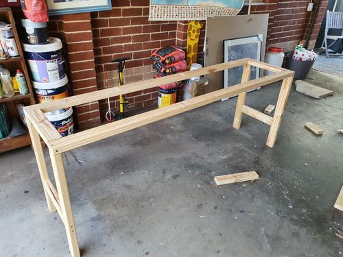

I made a variation on my computer desk build for my youngest son who just started High School. It measure 2000m long, 500mm deep and is about 780mm high. The bill of materials and the instructions are in my previous post "computer desk build" but this time I decided to use a spotted gum top which was available from Bunnings.

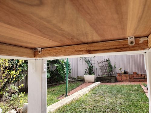

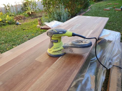

We painted the frame using Dulux Gloss (White on White) and gave it three coats. The top was sanded with 240 grit sandpaper and coated using Timber Protect One Coat Clear (water base version/gloss). Three coats were applied with a final sand down (hand-sanding) after the last coat.The top was fixed to the frame using a adhesive and brackets to hold the top in place. I made the desk at 500mm deep to fit into the space and not to overwhelm his room.

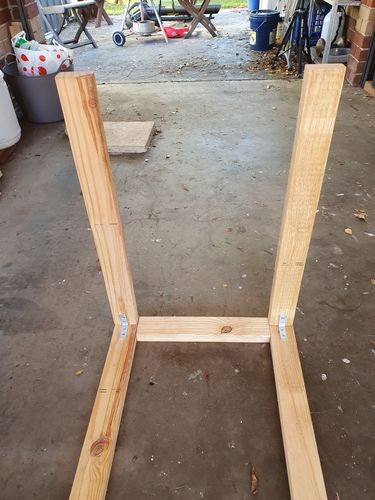

Joining the legsJoining the legsAssembling the timber frameAssembling the timber frameAligning the bracketsAligning the bracketsFixing in the cross barsFixing in the cross barsFrame all done in 30 minutesFrame all done in 30 minutes

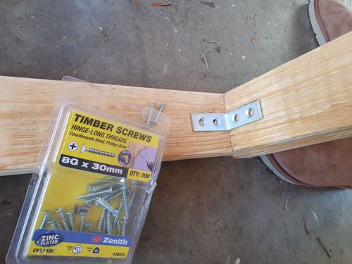

Brackets to hold the legsBrackets to hold the legsBrackets to hold the topBrackets to hold the topSanding - it is so important when getting the top readySanding - it is so important when getting the top ready

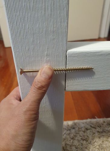

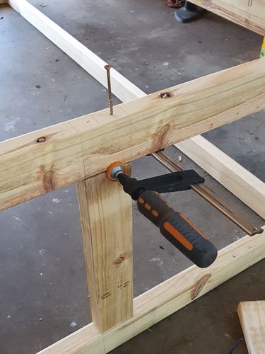

Hi @donalla, I used 10G x 100 mm countersunk ribbed head screws, which you can get from Bunnings. They are around $11-12 for a pack of 50 screws. These were used to attach the cross-bracing between the legs in the middle and the upper frame. The reason I used 100mm length was that the timber was 700mm wide (see image). I found that pre-drilling holes makes it easier to screw through the wood and keep everything straight. To build the frame, I used twenty 10G x 100 mm screws to join the wood and sixteen 8G x 30mm screws for the brackets. I am amazed at how strong the frame is when you have all the screws and brackets in place. Good luck with your work table:-)

Fix two screws, upper and lower into the cross bracesFix two screws, upper and lower into the cross braces
