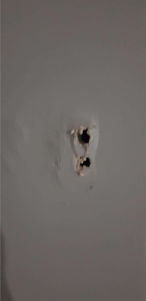

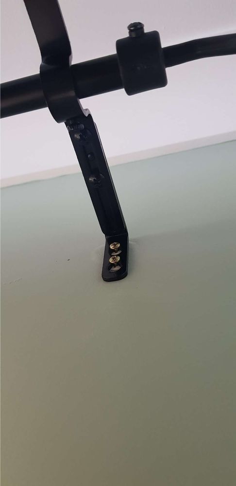

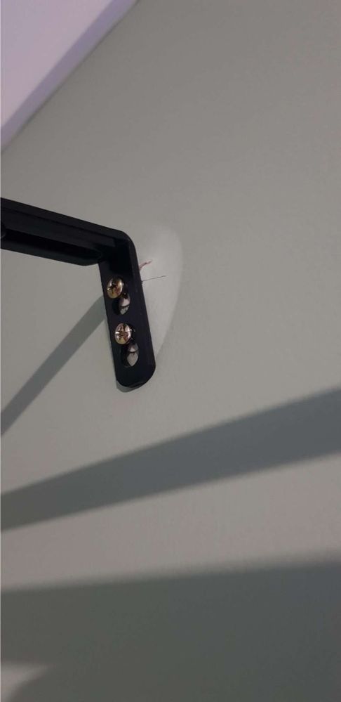

Now I am seeing some swollen (sorry, if this is not the right word) drywall around the top screws in the bracket. Did I do some mistakes here or did I follow some wrong methods? I am worried if it brings down the drywall. Please check the image here:

With plasterboard fixings, you should use a product that exceeds your required weight. If you use fixings which only just cover the weight of the item then over time they will pull out. In your case, you have a standout bracket which puts the weight of the curtains away from the wall and this exponentially increases the stress on the fixing. What might have weighed 3kg now weighs 5kg and is maxing out the fixings. If someone was to then pull on the curtain you would be exceeding the weight that the fixing can support. For curtains, I would recommend spring toggles as they can support up to 10kgs.
This might not be a case of too much weight but possibly how the fixings were installed. The raised plaster can be caused if the plastic screw fitting is overtightened or if you do not apply forwards pressure when screwing it in or the plaster/paint was already compromised. This raised plaster could just be a cosmetic top layer of paint/plaster that is being pulled out like this. I've had a similar thing happen to me on several occasions. The fixings have all still held perfectly fine in the wall.
If you are worried about it damaging the plaster further then you could remove it and replace it with a spring toggle.

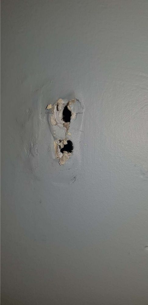

@MitchellMc
After 3 weeks, it did not work and I found out this yesterday.
These are rods with 5+5KG(Left), stud & (5+5kg) right wall anchors.

Hi @Sugar,
There seems to be a lot of damage being done to the plaster by these fixings. Either the plaster is compromised, or there is more weight than the fixings can hold. Normally to pull the plaster away like that a significant weight above 5 kg would be needed. In the images above, you can see by the texture that there has been a previous repair to the plaster in this section.
I think the best option is to use the spring toggles and to move locations if possible.
