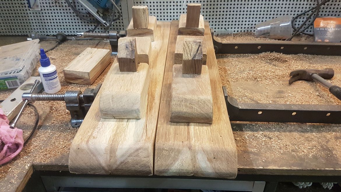

May I have some details on how you constructed the legs for the table please.
Re: Table made from hardwood pallets
Welcome to the Workshop community @Bryan2409. It's great to have you join us!
Let me notify @dean of your question to see if they are able to provide some assistance. The legs they have created have some elegant construction techniques and it would be great to hear in some detail how they were made.

Hi Brian, i created the legs and feet with the batons from the hardwood pallets. I first glued them together and the screwed them.  i then created the extra bits to sit on top. The legs were the same. I really had no plan, as for anything i have built. I sit there and stare at the wood, and get ideas, and start from there..lol As this was one of my first things i built, i learnt a lot from my mistakes.. lol. I have attached some photos. PS..as this is hardwood from pallets, i am dealing with wood that is not straight - as you can see there is a bow in the legs..lol..that makes it more fun...

Thank you very much Dean, much appreciated. Job well done my friend.
