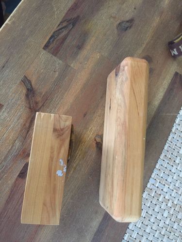

Re: Tea light candle holders
These tea light candle holders are made of recycled cypress pine.
In the photo below showing the holders edge on you can see the larger one is solid timber while the smaller is two bits of timber laminated together.
They can be made from any type of timber. They can be made with basic tools and a forstner drill bit (42mm) to drill the flat bottom holes for the tea light candle.

I used a 42mm forstner bit to drill the flat bottom hole for the candles. the bit is the exact size for the candles to fit nice and snug.
I do drill mine out on the drill press but you can also used a cordless drill which is what i did on my first prototype.
