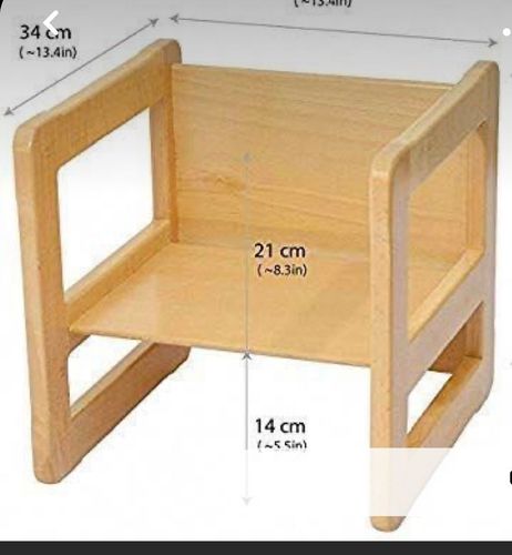

Would you be able to show us an image of the style of cube chair you wanted to build? I presume it is the very basic Montessori styled chair, some of which feature a steam-bent backrest?
You could use plywood, or my preference would be a solid timber like a 300 x 18mm x 1.2m Pine Utility Panel. You shouldn't have too much trouble building the basic version of this chair. That steam-bent backrest which some of them feature is likely not going to be easy to achieve, though.

Here’s me trying to share the photo. It’ll be similar to the bottom but.. I will be using panels without holes. Also wouldn’t be steam bending anything (lol) as it’s currently Jedi master level. Would be countersunk wood screws and wood fillers.
Thanks for the advice! 😃 I’ll take a look at both wood panels.

Thank you so much for posting that update. My top suggestion for your project is to use an Ozito 200W Detail Sander. This will greatly speed up the sanding process for the entire project. This tool will allow you to thoroughly sand not only the top of the panels, but the sides as well giving you a smooth splinter-free finish. Will you be rounding off the corners of the chair? A good way to do it is to place a can of beans or similar on the corner of the panel and trace the arc of the can. You can then use a Trojan 165mm Coping Saw to cut the arc line on the panel.
If you are feeling creative, one way to cut holes in your chair is to use a Craftright 16 Piece Holesaw Set. This sounds like a fantastic project to build. If you have any other questions, please don't hesitate to post them. Our members would be more than happy to provide advice and information.
