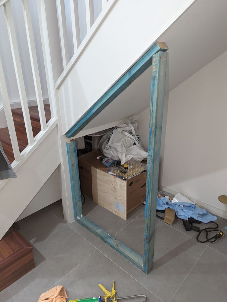

Getting progressed... Frames are done...........

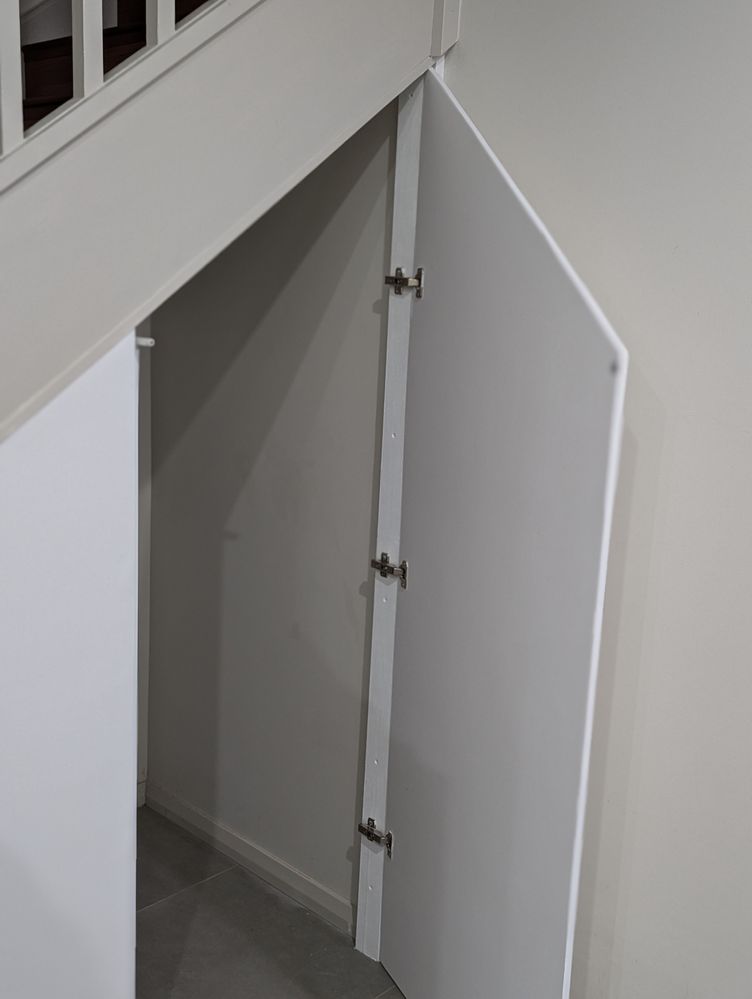

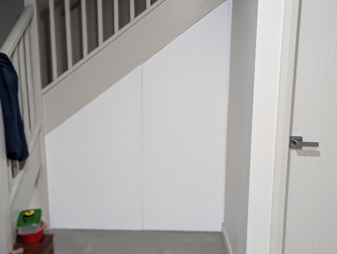

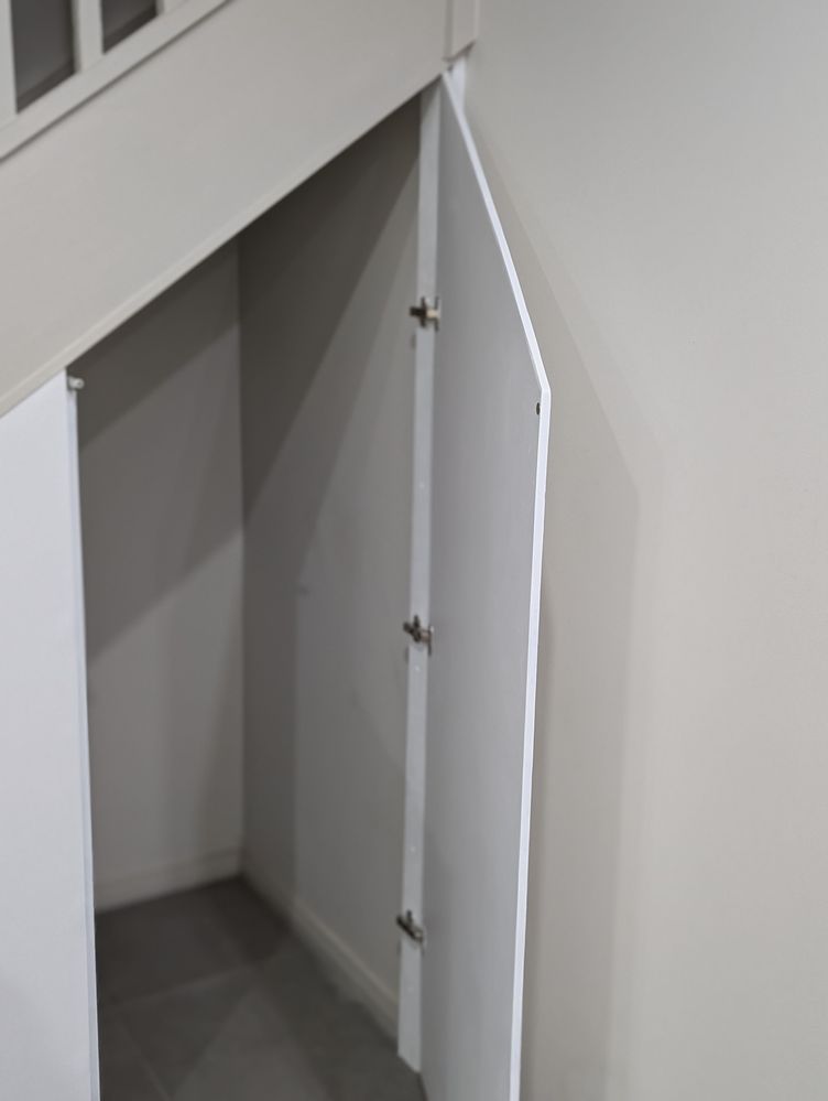

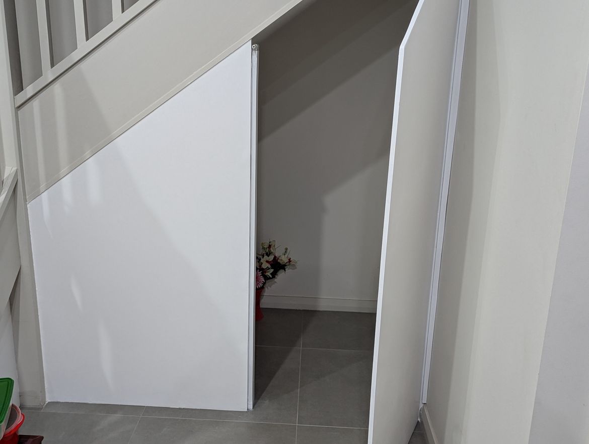

Fully completed now......
used plywood and door closing hinges....
1200 x 800mm 12mm Plywood Red Oak - 12mm
Painted....
