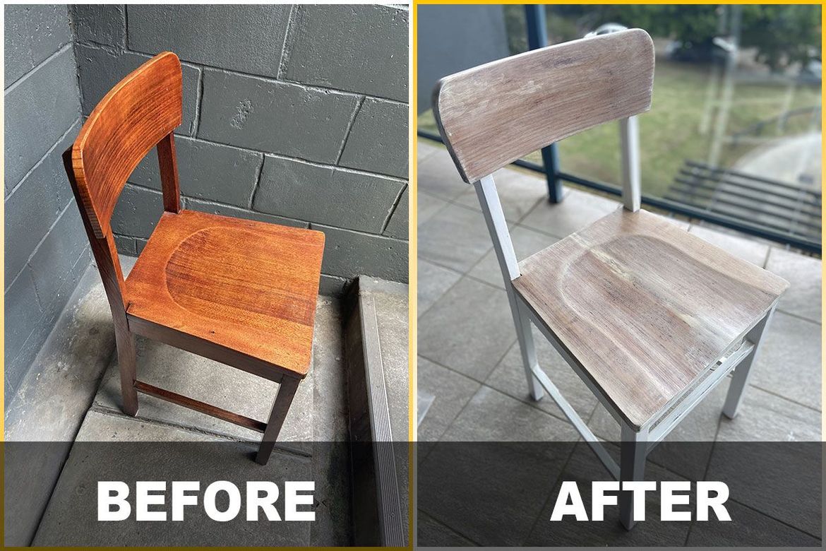

This is my first time refurnish project.
Lots of mistakes and few thing I hope you guys can give me some advice for the paint.
I have two identical chairs, the first one done, I don't want to make same mistakes again.
I used Chalk Paint and I found the paint texture not really I hope for.
Whats the options for the paint, indoor chair but I may put them outsider in covered alfresco now.

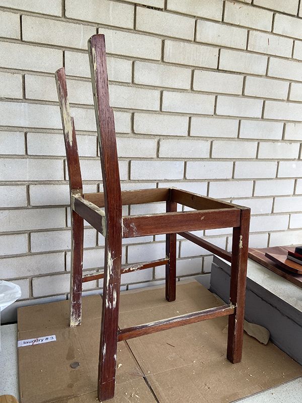

I was planning to the wood stain for the panels at the beginning. but I found the chair itself wasn't a fine wood so lot of fix and half way i found the crack as well.
This time I won't take out the screw for the sitting panel and just leave how it is. back panel of the seat has been taken out and I look for the paint and colour options as well. First one is White and kinda White wash for the panel. Now I am thinking the second one probably white and green colour for the sitting/back panels? What do you reckon?
and what kind of brush I should use? I use the fine paint brush at the beginning and still leave many brush marks even I sand it. Some recommend using small roller brush may improve the result in large surface.
Do I also need dilute the paint before I paint?

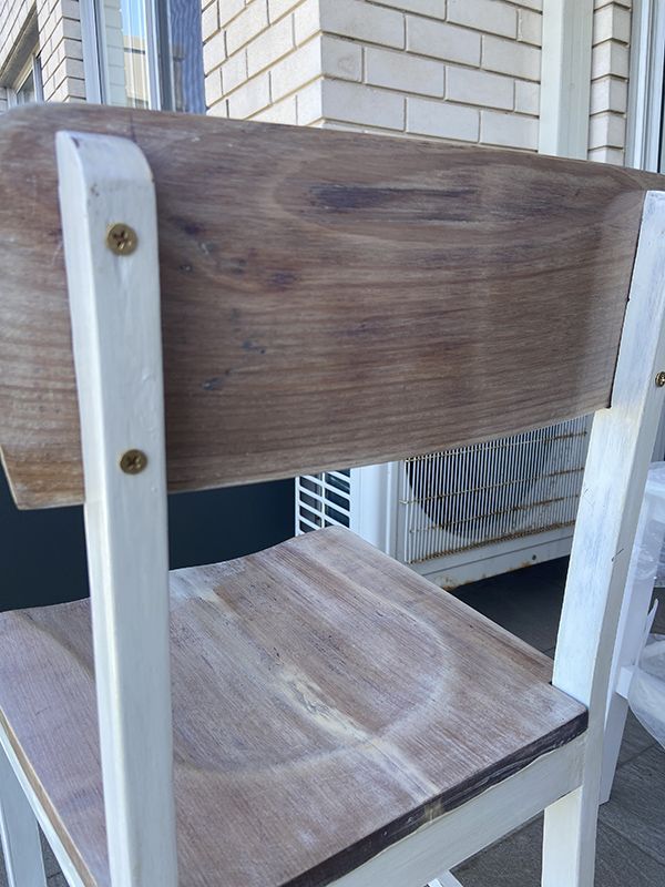

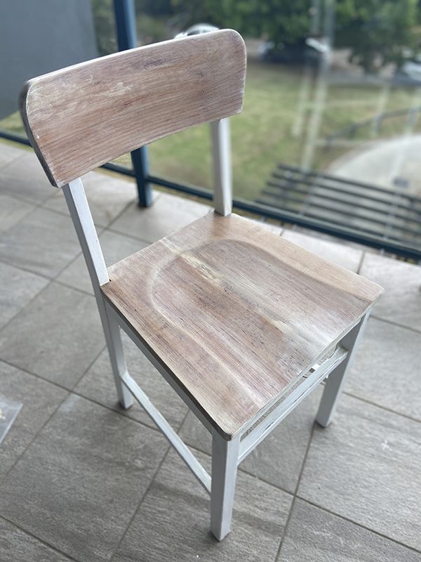

I attached the first project I made
At the begining of sanding. Panels off the chair.Sand it by hand. 80 first then 120 then 220.
Wood filler for the holes and uneven surfaces and sand it again
Paint with Primer: British Paint 4in1 water based primer.
Chalk paint and distress surface a bit. replace in gold screw. The panel of the chair I was using Feast Watson Satin. It left the orange-yellowish coat on it. My mistake was also applying on the white chalk paint plus my uneven paint skill. It leave the uneven dirty coat

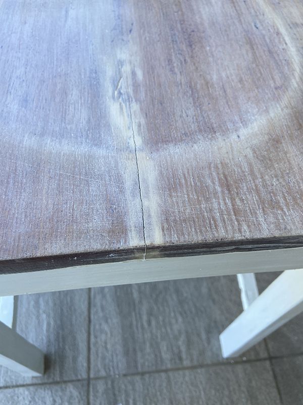

It cracked after assemble back. I think next time I should use more wood instead of the screw back in. Gives too much pressure for the panel.
I still happy what I did. and now i have another go.
ADDED ON: After I used wrong Vanish on the Paint (def is my fault. I did resand a bit and use Waterbased Clear Wood Vanish from bondall. The result is much better.
