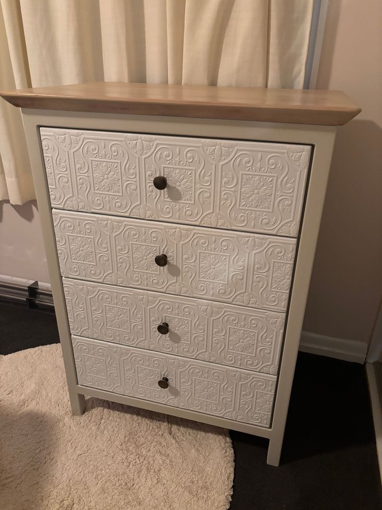

Got this set of Drawers free off Marketplace for our spare room. It needed a whole fresh look to be ready for it’s next life.
sanded, undercoated and topcoat then clear coat. A Wagner spray gun bought from Bunnings helped with an even coverage for much needed primer. Foam rollers were used for a nice smooth finish and bunnings wallpaper was used for drawer fronts. Hobby glue then sand off edges, sealed with clear top coat ensuring it will last and wear well.
Mouse sander
wagner spray gun
dulux tan colored paint in part water for a paint wash on the top.
white embossed wallpaper
hobby glue
clear coat
white primer
new knobs
80 grit sandpaper for removal of wallpaper edges
Cleaned with sugar soap
sanded with 120grit using a mouse sander
primed with white primer using Wagner spray gun
top coat x2 using foam roller
wallpaper glued to drawers provide fronts, edges sanded off
tan paint wash to top
clear coat all over
new drawer knobs

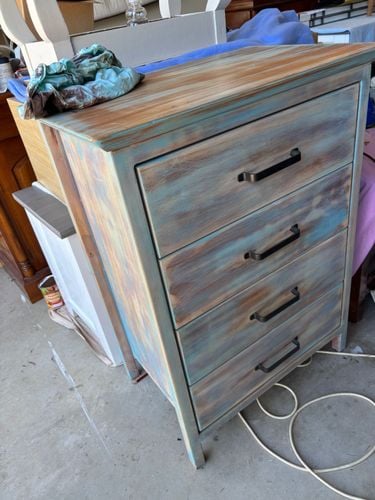

before
before
before
before
