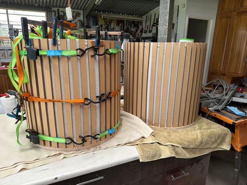

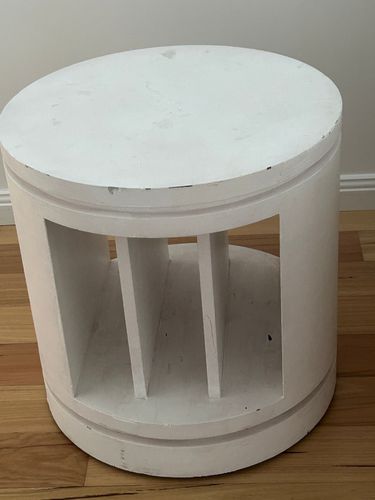

I took a round coffee table/magazine rack and added a new top using a SpecRite Round Timber Pine Panel to the top.
Step 2
I cut SpecRite Timber Slat Panels in 600mm lengths and secured the top and bottom with tech screws. I then applied Selleys Fast Grab Liquid Nails to the walls of the coffee table and progressively wrapped and screwed the panels around the coffee table. I also used quick action clamps to secure the panel as I moved around the coffee table. Finally I used Ratchet Straps to hold the panels until the Liquid Nails set.
Step 3
Once the panels had been secured I then added Taskmaster 10mm White Screw Caps to all screws.
Step 4

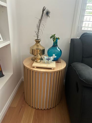

Finished Project.

The transformation of your mobile coffee table is truly impressive. The use of SpecRite Prempanel Timber Slat Panels in Oak has given it a modern and refined appearance, beautifully complementing the natural tones of your flooring. What was once a basic and dated piece now looks like a stylish, high-end side table. It’s a fantastic example of how thoughtful material choice and craftsmanship can completely refresh and elevate a space.
