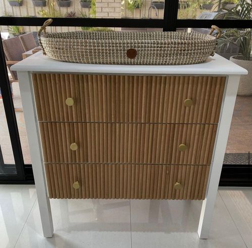

Upcycled these drawers for our nursery.

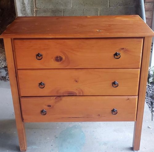

Yes I sanded the chest to remove old stain and smooth surface as much as possible. Once that was done I applied three coats of Dulux Lexicon. Dowel was cut and attached to drawers using Gorilla Wood Glue. I then applied single coat of Cabot’s Cabothane Clear Matt. My husband drilled holes into drawers and the brass handles were screwed in. Hope this helps anyone wanting to do something similar.
