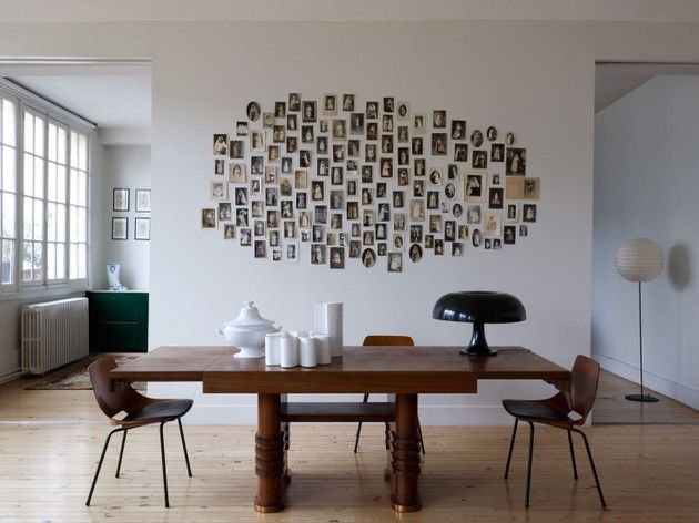

Thx both @EricL and @prettyliving.
My thought is randomly attach pieces of photos without photo frame to the photo wall.
Eric's suggestion is good but I prefer the board to be less than 5mm thick.
I'm not sure whether there is such thin board or not.
Would you please give me some more advices ?
Below photo is downloaded from web so that you can understand my thought.
Thx.
Re: What backboard to use for a photo wall?
Hello @FC
Thank you so much for posting a photo of your idea. I recommend using three pieces of the 1220 x 610 x 6mm AA Grade Mixed Hardwood Marine Plywood. I suggest painting and installing them together to form your backboard. However, if you need a bigger panel you can use the Custom Wood MDF 3mm 2440 x 1220mm White Melamine Backing. The edges will need to be painted white, but this board is ready to be installed and used.
How will you be sticking the pictures to the panel? Will you be adding and changing pictures often? You could use Rust-Oleum 887ml Primer Magnetic Paint in combination with Everhang 3000 x 13mm Self-Adhesive Magnetic Strip to mount the pictures. This allows you the freedom of changing the pictures without damaging the finish on the panel. This sounds like a fantastic project, any updates you can provide would be much appreciated.
If you need more advice or information, please let us know.
