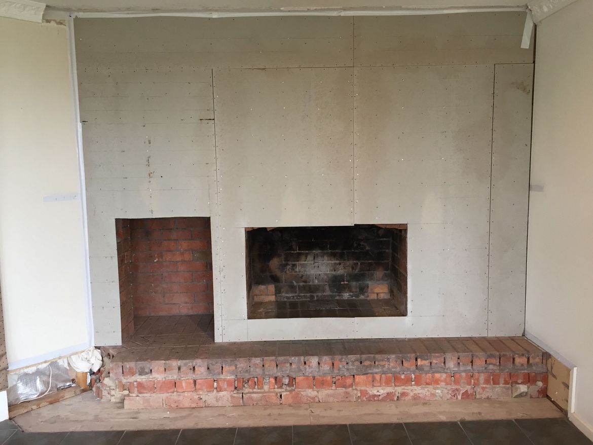

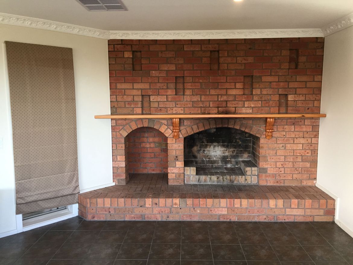

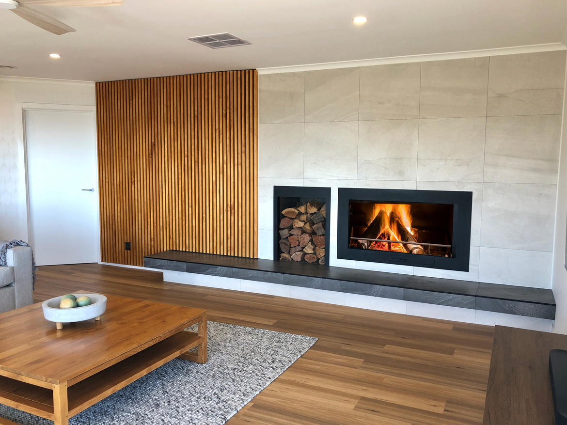

Rendering may not be suitable either around the closest areas due to heat cracking the material. Tiling over the brick such as what I have done in the photos below to modernise the fireplace. It would build out the brick surface by around 20mm so, ideally you wouldn't want to cut the tiles around the outer face of the heater, but instead if it can be pulled out say 30mm to lay the tiles then pushed back to meet them flush.
Regards Nailbag
Seriously @Nailbag
That is beautiful! hahah I look at stuff I have done and then you show us what you have done...
Ten steps up! And that would be a very nice solution for sure!
Thanks mate. A LOT of work went in to that project!
