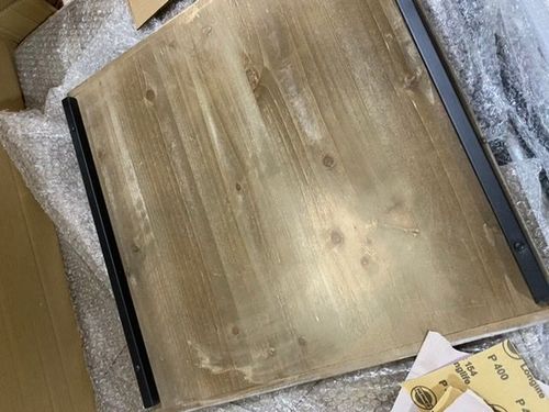

Thank you all so much. Here is a pic where we’ve lightly sanded a section. Looks like we may be able to lighten it a little bit with sanding before we test out staining.
Re: What type of stain would be best to try and match our coffee table to dining table?
@Laura_P,
That's perfect. It will be much easier to find a stain to mimic the dining table starting with that sort of colour. I'd recommend you take your coffee table into a Bunnings store during non-peak hours and speak to one of our helpful team members. If you take a picture of your dining table with you I'm sure the team member would be more than happy to try a little sample of colours on the bottom of the table for you.

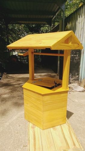

Whether that grey finish is a wash or just weathering, I doubt there's a stain that changes grey into the colour of the dinning table. I'd spend the time sanding it back to raw timber before staining it. I'll add a photo of a wishing well I made out of pine and stained with teak stain. Sort of comes close to the colour you're chasing. However, if you sand the top back to raw you could use Danish oil again and probably get an even closer match.
