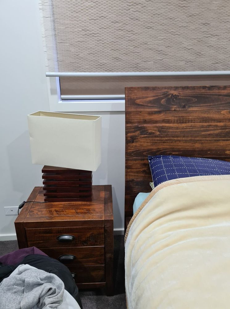

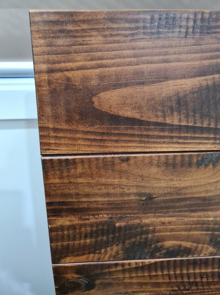

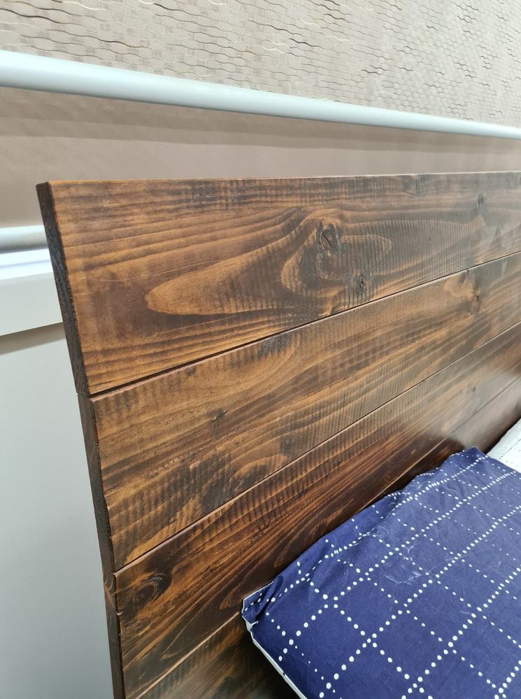

I've attached some photos of the bed head and drawer.

Firstly I'd like to address that this is a distressed look stain applied over pine and not just a solid coating of stain. The different layers of growth rings have absorbed a varying amount of stain which is creating this look. Were you going to attempt to get the same distressed look or just colour in a similar tone? To get something with this effect you would need to use solid timber and not finger jointed project panels. Project panels are small pieces of timber glued together. You can see the growth rings on this 600 x 18mm x 1.2m Pine Utility Panel which would be more suitable. You would need to build the coats of stain up slowly, as you will cover over the rings completely if you use a heavy coat.
Most of those project panels are fairly neutral in colour and much lighter than what you want to achieve. Colour-wise I'm liking the look of 2200 x 600 x 26mm Acacia Solid Oiled Hardwood Project Panel, however, it already comes with an oiled finish. The oil will prevent the stain from penetrating the timber and would need to be sanded off with 240grit sandpaper first.
You can apply a stain on any of those project panels from the Feast Watson's colour chart below. Brown Japan is coming fairly close to the correct colour, but several coats of the oak might do as well

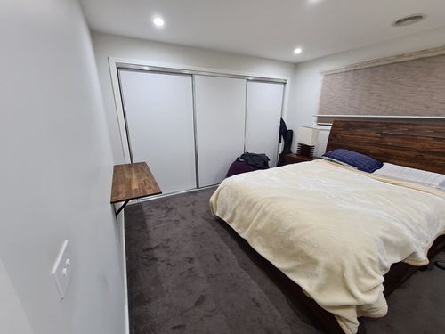

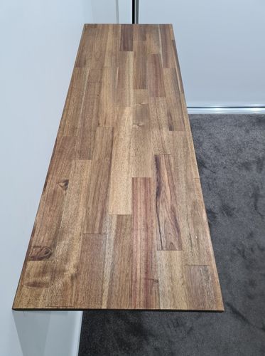

Desk installed!
Thanks for the tremendous help @MitchellMc. The desk managed to blend in nicely with the bedhead.
Loving the floating minimal style, with the added benefit of easy vacuuming below.
Was thinking to hide the brackets for a cleaner look, but I personally like the look of the brackets.

Great job! That looks fantastic and is a wonderful addition to the room. I like the look of the brackets also and as they are fairly minimal I don't see a need to have them hidden.
