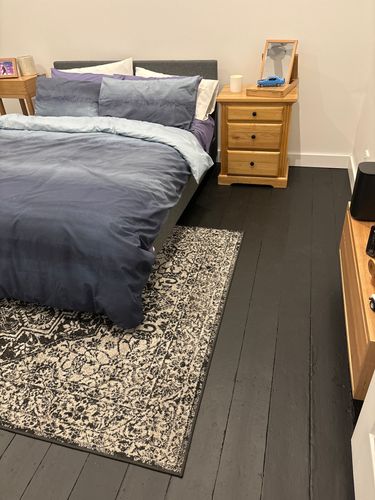

Finally finished painting my timber floor, I ended up using Haymes premium , exterior low sheen extra dark tint, Black paint
Re: Which paint to use on timber floor?
That looks stunning @JoeAzza
I'll be interested in hearing the long-term results of using an exterior acrylic instead of a dedicated floor paint. If it holds up, that would certainly open up more possibilities colour selection wise. You'll need to keep us updated.
Many thanks for sharing your finished project. I trust you're super excited with the results.
Thank you @MitchellMc, for extra protection , I have ordered a large rug to help reduce wear on the the painted floor.
