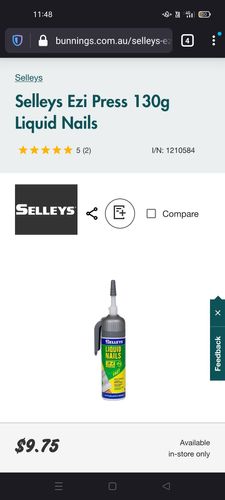

Hello @gavin16
Welcome to Bunnings Workshop! Selleys Aquadhere is an excellent glue for wood working projects but not for exterior fixings. I suggest using Selleys Liquid Nails. It comes in a small ezy squeeze bottle no gun needed. After applying the glue simply push the timber back in to place. You may put some temporary tape to keep it in place until the glue dries. But once it has set you can take the tape off.

Hi @gavin16
Liquid nails thats what we used for all our trim work which went directly onto brick and no issues!

Welcome to the Bunnings Workshop community @gavin16. It's amazing that you've joined us, and many thanks for your question about adhesives.
It's wonderful to see you've already received some help. As @redracer01 and @housetohome have mentioned, liquid nails would be your best choice. You can also use the clear version, which can be a bit more forgiving if you apply too much or things get a bit messy.
