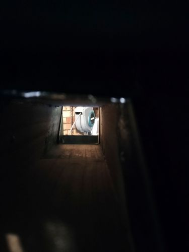

Hi Jacob. Here's a photo I took through the lens. It needed to be painted black inside so the light is more concentrated.
I made so many mistakes while making it. I should have made it a test one but don't have time to made another.
Cheers. John

Hi @asifaussie,
It's unfortunate you didn't have time to make another with the improvements you'd like to have made, but it certainly looks like it is working as intended.
Thanks for sharing the photo.
