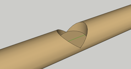

You could drill out a section of the horizontal piece with a drill bit (spade bit, or forstner bit) the same diameter as the rod, but not all the way through. Then push the vertical piece in with a bit of some wood glue wood to keep it secured.
Sort of like this... (playing with the new web version of SketchUp at my.sketchup.com)

I would suggest the same thing as @Mick0s. Enjoy!

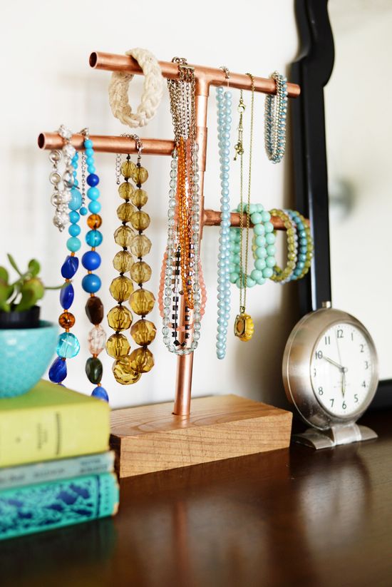

Or you could use some pieces of copper pipe with T fittings. Or even a copper T piece with your existing wooden dowel.
