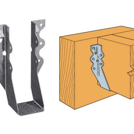

Hi @Nalkur . Whether it's laminated or solid timber, my main concern with screwing into the end grain is splitting. You could consider using Triple grip type bracket as pictured. Although if your end panels aren't thick enough to accomodate a decent size nail or screw from the inside you may need to resort to nails or screws into the beam from the outside. In which case i can only suggest pre drilling the holes as deep as you can.

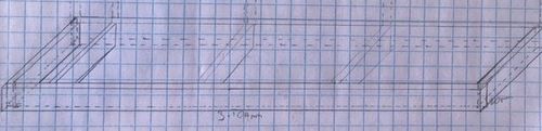

Thanks for you reply. I was considering the use of 90 x 35 LVL ebeam for the plinth. Will need about 8m of the stuff.

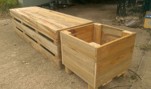

yes I wasn’t sure about splitting either. Just had another thought when I saw your post. Chocks in each corner inside the plinth and face screw the cross members to the front and back. Would that work?

 I think I know what you mean. I use that idea in the corners of some of my planter boxes and bench seats. It works well to stop splitting.
