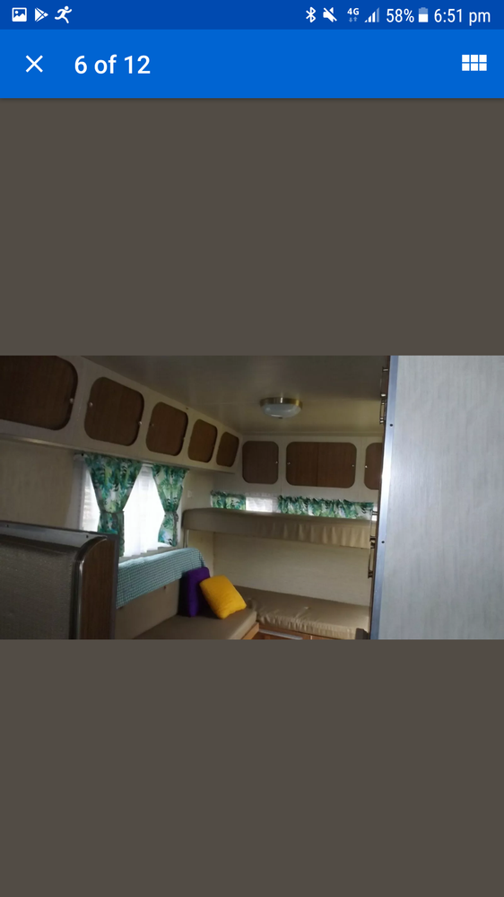

replacing old fold out wooden bed
nuggetnavi
Wood fold out base under cusions in photo. Its old and warped really hard to pull out into bed ! Need strong lighter material suggestions thanksScreenshot_20190812-185116.png

Cheers Jason, @nuggetnavi I made a slide out bed in my first caravan reno but modified it so it joined up with a second bed for an east west double
Furniture connectors from ebay to support itFurniture connectors from ebay to support it
Credit for design goes to Deep Red Motorhome for their easy to follow build instructions http://deepredmotorhome.com/bed.php
