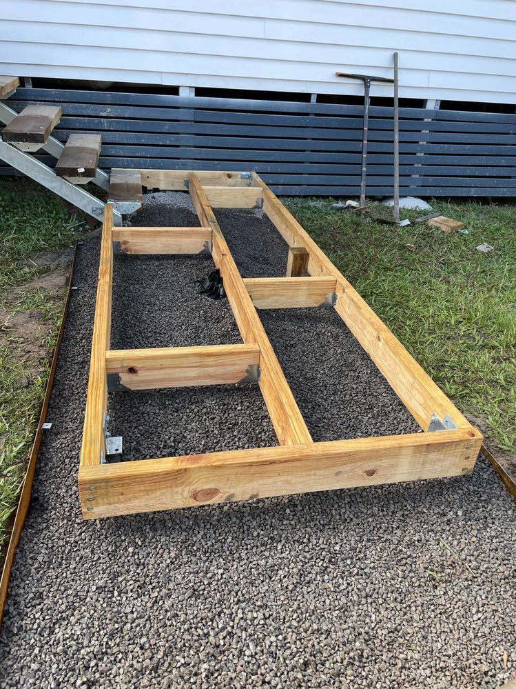

IMG_0675.jpegAs low decks seem to be a constant subject of interest I thought this was worth sharing as a slightly different situation.

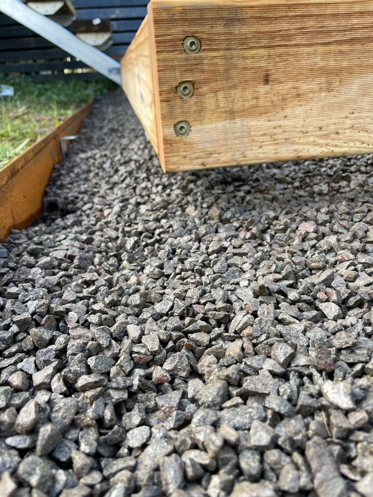

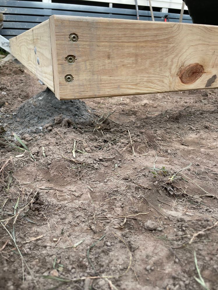

We needed an elevated entry to a new door into our house from the driveway. Being a very level block and having high rainfall it had to provide a dry entry. There is a very small amount of slope in the area so the gravel ensures water can easily flow.
I wanted the deck to be at the same level as where the first step-tread should be on the stringers. That meant I needed to install the first step-tread upside down (underneath).
Due to its position beside the drive in an area that is used for 3-point turns I didn't want to put the edge of the deck right on the edge of the drive as I knew it would be reversed into hence the setback.
Not finished yet as I need some merbau treads & they are impossible to find at the moment and once I have them in I'll dress the side to conceal the stringers & I'll fill the riser gaps too.
I just thought the stages of ensuring clearance may be of interest.
External frame and posts in.External frame and posts in.Cleared away soil beneath frame.Cleared away soil beneath frame.Lay drainage mat & add gravel BEFORE finishing frame. Much easier that way. If you don't add drainage mat then gravel will, over time, sink into soil.Lay drainage mat & add gravel BEFORE finishing frame. Much easier that way. If you don't add drainage mat then gravel will, over time, sink into soil.Framing finished. For the main supports I used stirrups in concrete. For the secondary I used Tuff Blocks as the gravel gave a perfect base.Framing finished. For the main supports I used stirrups in concrete. For the secondary I used Tuff Blocks as the gravel gave a perfect base.Drainage gravel in.Drainage gravel in.Deck laid. 140mm boards. This is same size as bearers so can also be used to conceal them on exposed faces. Another layer of drainage mat laid onto drainage gravel around edges and then dressed with river pebbles.Deck laid. 140mm boards. This is same size as bearers so can also be used to conceal them on exposed faces. Another layer of drainage mat laid onto drainage gravel around edges and then dressed with river pebbles.

the holes were only around 3 to 400mm wide and around 400mm deep. Our soil is quite stable so don't need to go much larger. Each took about 1.5 bags of quickset.
As it's a level area the concrete really just becomes a stabilising dead-weight. It's not a structural footing as it's not taking a major load or on a slope etc.
And a note on concrete... I feel confident using these smaller footings as I've switched to using a high MPa concrete mix as it doesn't crack or crumble like the lower grade stuff.
The lowest point of clearance above the finished gravel was about 50mm and there was around 40mm or so of gravel above the soil.
