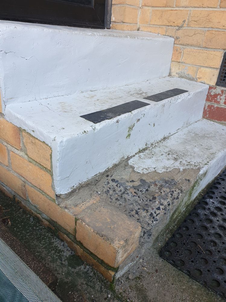

I was just hoping to get some advice on updating the outdoor steps at the back of my house.
These are a bit all over the place, have narrow treads (that are not uniform) and can be a bit slippery and dangerous when it rains (please see photo 1).
I'm installing a deck that will be just above the level of the bottom step (so the bottom step will be covered by the deck), but before installing the deck, I would ideally like to:

As I'm planning to do this myself (with my pretty basic skills), I'm wondering if anyone has some advice about the easiest and best way of going of about this?
For instance, would either of these options work well:
1. Remove concrete layer, mortar in additional bricks to extend treads, and then (using mortar) pave/tile directly on brick
2. Keep concrete layer (which isn't particularly level), pour additional new concrete to extend treads, and then (using mortar) pave/tile on concrete.
Or would it be better to demolish the existing steps and start again?
Any advice would be greatly appreciated.

Actually started to remove what I thought was the overlay layer of concrete but (deceivingly) it turned out that, other than the external facing bricks, the steps are solid concrete, which was difficult to break up even with the rotary hammer drill chisel function (please see attached), so it's back to the drawing board.
Given that I'm installing a deck, I was thinking that I might just use deck framing to extend the middle step out to the bottom step (and place composite decking boards on top), which the deck will butt up against and be at the height of the current bottom step.
To do this, would I essentially do something like the following:
  • create a box frame with say 90x45 H3 treated pine (and say 3 small joists in between as the step is about 1m in length) that I attach to the bottom step with say Ankascrews or dynabolts, ensuring adequate air gap (with plastic packers etc).
  • Cover frame with joist tape
  • Lay decking boards from the front of the step toward the back
  • Attach fascia decking boards
Any further thoughts would be greatly appreciated!
